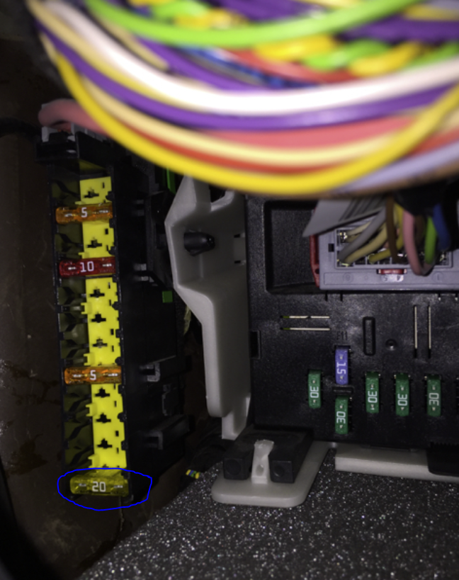

Honestly I'm not sure how to find the fuse you are talking about. There are some but I'm just not sure
This is the pic of the box

Re: C4 Picasso 2007 heated seat connector
I'll take a look shortly, but please upload your images directly to the Forum in future, it's a lot easier for us and third party image links are awkward to use as it involves switching away all the time, thanks. :wink:
It's here to the left:
I've circled it in Blue.

You are THE BEAST Marc, I really appreciate your comment. And sorry for the link, will make surento use the feature in the future.
