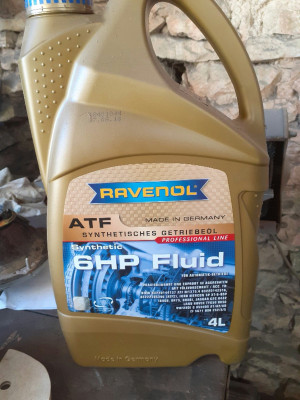

Hi Marc many thanks for the reply.
My local garage did the gearbox oil change when they did the timing belt and waterpump and fitted a second hand EPB assemby at the same time.
They did 3 oil changes, but I don't know about the re-setting of the counter, and the garage is shut for holidays now until the 22nd August.
Currently I do not have any warnings on the dashboard and I will try and get a Lexia on the car later this week and do a scan.
The oil used is RAVENOIL ATF 6HP Fluid
Thanks
Mark

I'd need your VIN (automasked on post submission) to check your Euro Standard to advise of the correct oil standard for this specific vehicle and gearbox version of the AM6.

Ok, so your vehicle is Euro 5 rated and will be an (AM6-2 / AM6-2 / AT6/ AT6-3) type gearbox, as opposed to the earlier AM6.
So the PSA recommended oil is JWS 3324 or AW1 equivalent, (PSA Part: 9734R7 for a 2 litre container). Don't use JWS 3309 oil which is a different specification and was for the earlier Euro 4 AM6 Gearbox.

Seems like Ravenol does not have needed type of oil in production.
