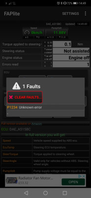

I've got Fap connected finally using a a vgate Pro obd and it has come back with the following fault.
I also scanned it with another app and this came up
Any ideas??

I'm not getting P1234 as a valid fault code for this vehicle, but here is the other one:
