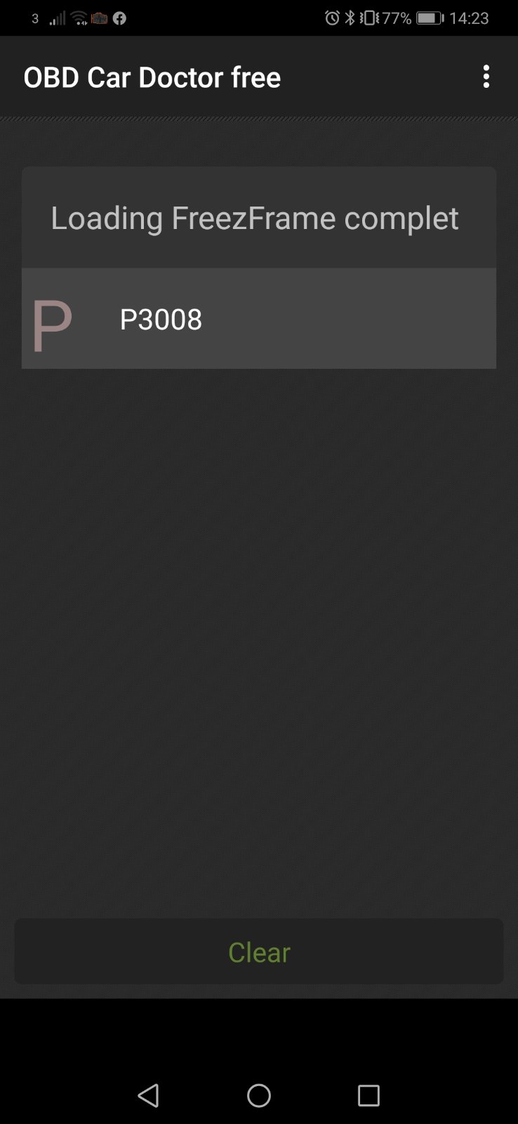

As promised I'm back! And it's a strange one!!
I haven't cleared the codes and the steering Fault has disappeared off the dash! Steering is as light as a feather!!
I've got Fap connected finally using a a vgate Pro obd and it has come back with the following fault.
I also scanned it with another app and this came up
Any ideas??

I'm not getting P1234 as a valid fault code for this vehicle, but here is the other one:
Fault Code: P3008
Description of Fault: Air circuit : Air flow higher than recommended. Ratio of measured airflow over calculated theoretical airflow below 10 % detected for 2,5 seconds.
The following conditions have to be met to trigger this fault code:
  • - In the pedal release phase
  • Air temperature between -20°C and 100°C
  • Battery voltage between 10 and 16 V
  • Turbo pressure between 740 and 1500 mbars
  • Engine coolant temperature between 50 and 110 degrees C
  • Engine speed between 1400 and 3000 rpm
  • Engine speed variation less than 16000 rpm per second
  • Air mixer open
  • Exhaust gas recycling valve closed
Conditions for Fault to clear: Driving for 5 minutes with decelerations of more than 10 seconds.
Downgrade Modes whilst Fault is active:
  • Switching of the turbocharging pressure regulation to controlled mode.
  • Deactivation of the request for regeneration of the particle filter from the diagnostic tool.
Symptoms:
  • Jerking/stalling
  • Noise
  • Lack of power
  • Smoke from the exhaust
  • Slightly higher fuel consumption
Suspect Areas:
  • Atmospheric pressure sensor in the engine management
  • ECU
  • Air flow meter
  • Air leak between turbocharger and mixer
  • Leak between air mixer and engine inlet (including EGR take-off)
  • Leak on the air mixer
  • Leak on the turbocharging air cooler
  • Turbocharger
  • Turbocharger fixed geometry control electrovalve
  • Turbocharger fixed geometry position repeat sensor
  • Turbocharging air pressure sensor
  • EGR exchanger with bypass
  • EGR exchanger bypass control solenoid valve
  • Position switch for the EGR exchanger by-pass
  • Electrical harnesses
  • Connectors

Cheers Marc, really odd on the power steering just fixing itself! Anyway I see smoke mentioned in the above as a symptom.
Coupled with the loss of coolant and it turning a different colour plus the fact when I opened the bonnet it was actually red hot in there around the turbo area so maybe its that as that's mentiond in the suspect areas.
