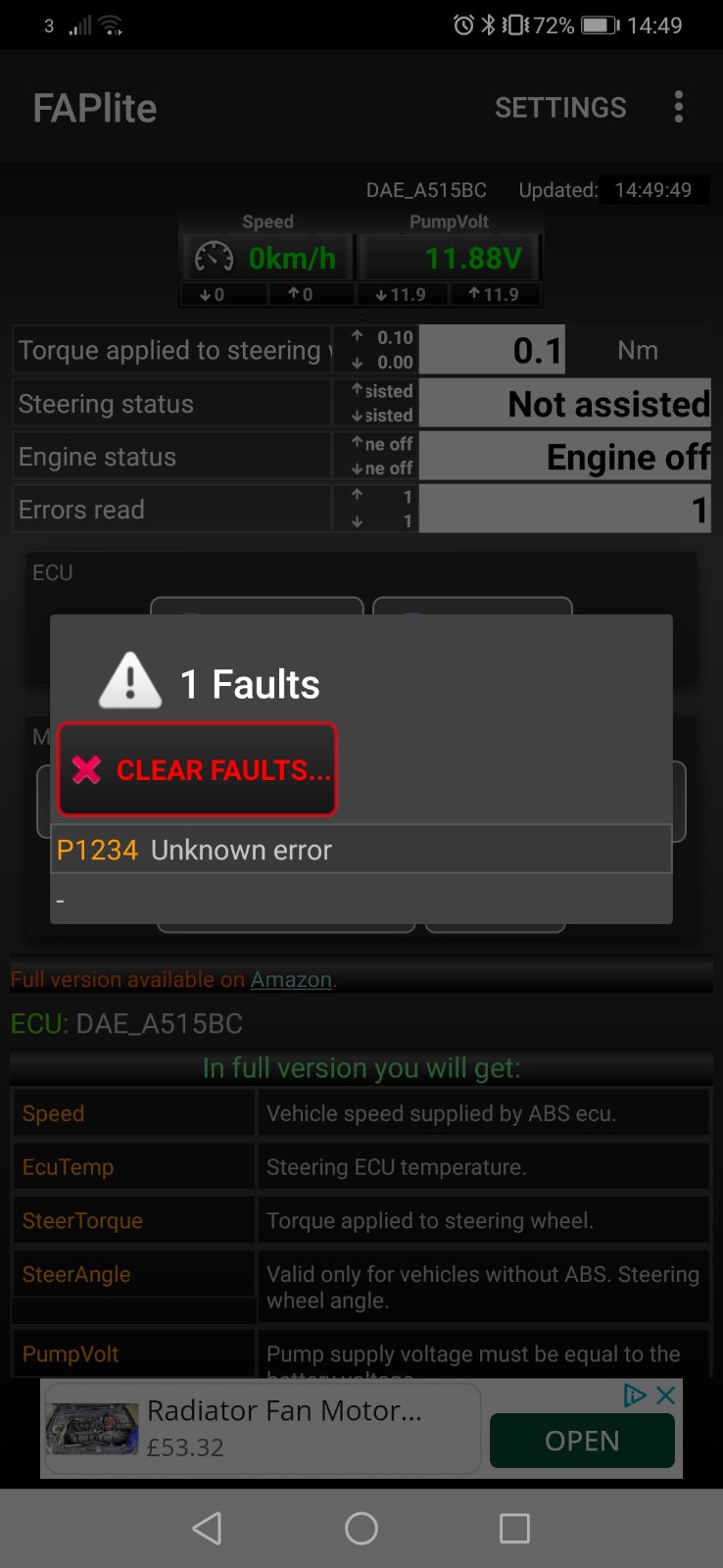

As promised I'm back! And it's a strange one!!
I haven't cleared the codes and the steering Fault has disappeared off the dash! Steering is as light as a feather!!
I've got Fap connected finally using a a vgate Pro obd and it has come back with the following fault.
I also scanned it with another app and this came up
Any ideas??
Any ideas??

I'm not getting P1234 as a valid fault code for this vehicle, but here is the other one:
Fault Code: | P3008 |
Description of Fault: | Air circuit : Air flow higher than recommended. Ratio of measured airflow over calculated theoretical airflow below 10 % detected for 2,5 seconds. The following conditions have to be met to trigger this fault code:
Conditions for Fault to clear: | Driving for 5 minutes with decelerations of more than 10 seconds. |
Downgrade Modes whilst Fault is active: |
Symptoms: |
Suspect Areas: |
