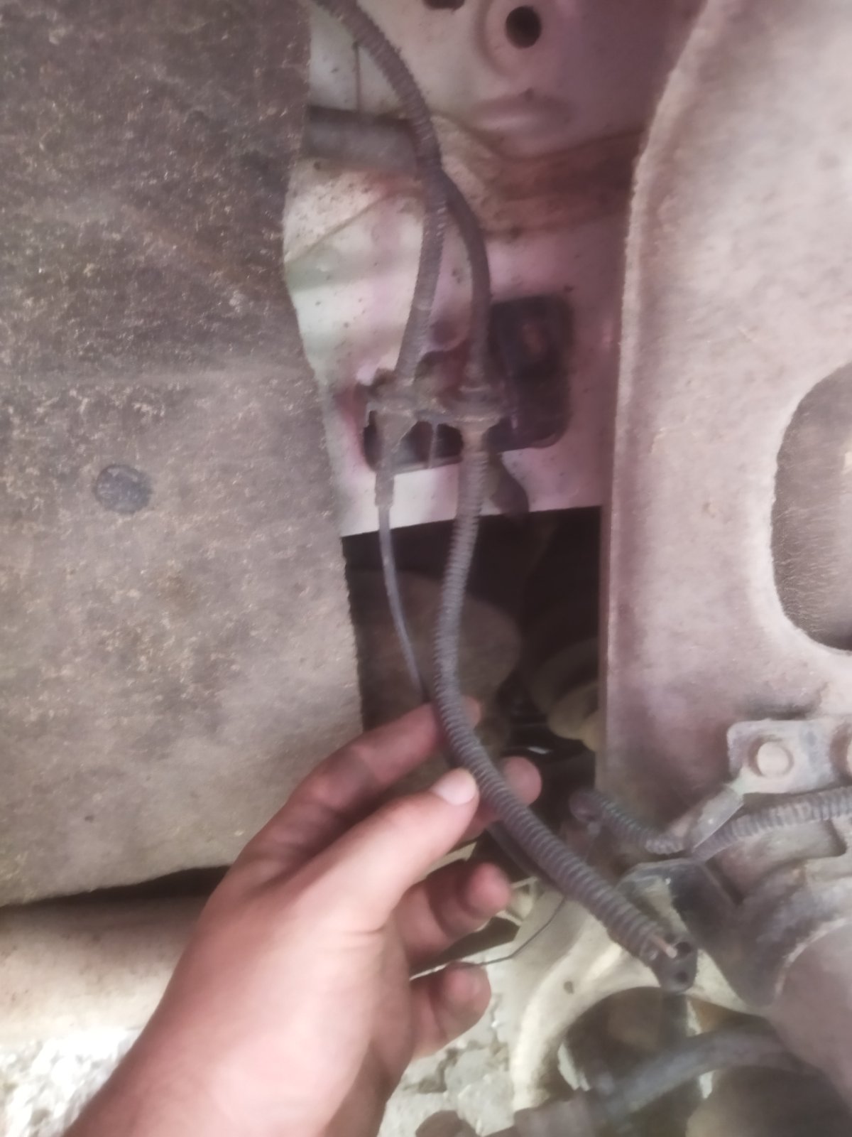

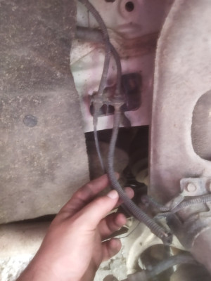

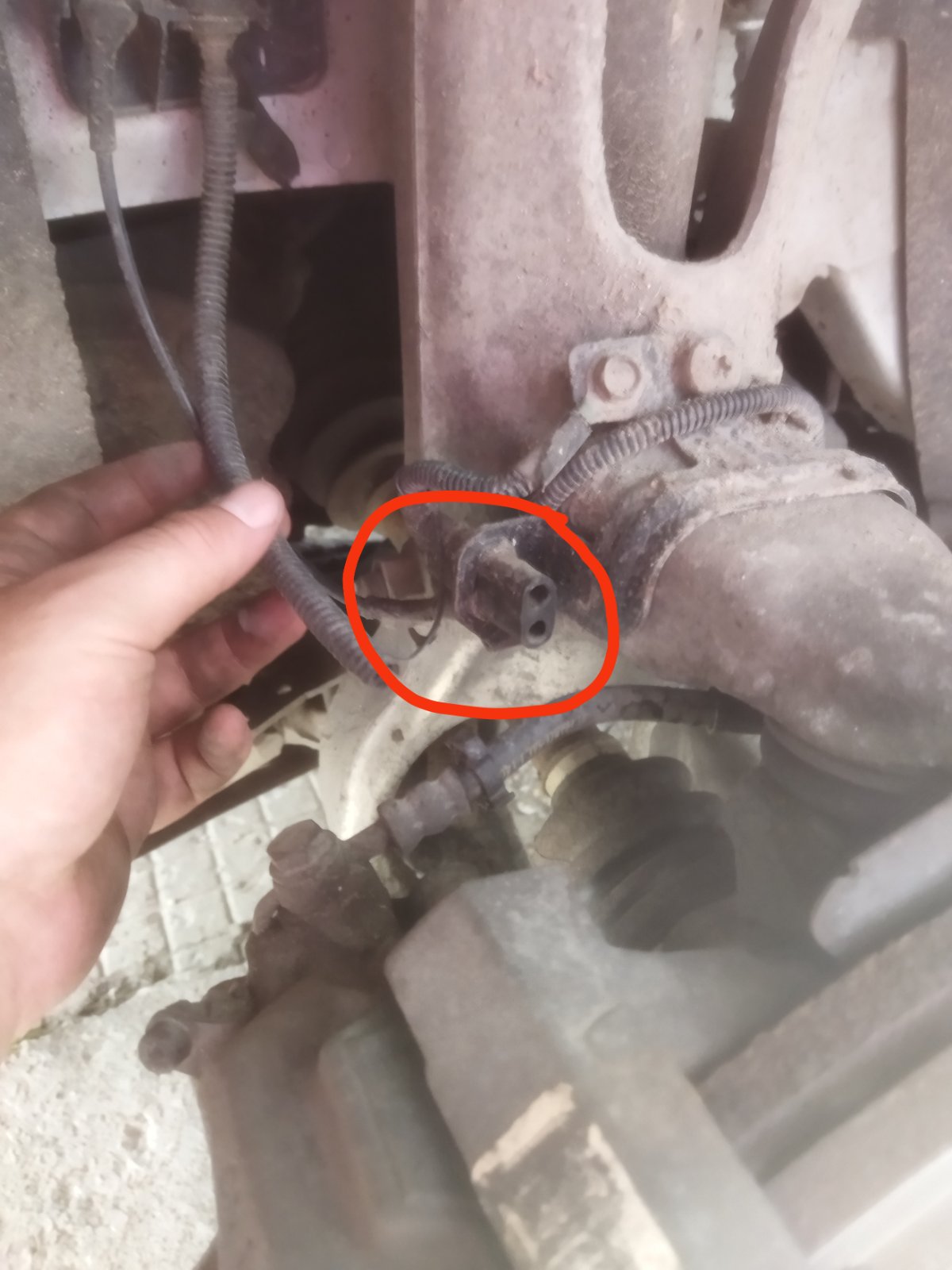

Hi all,
Today I was changing my tyres and I noticed that on the FL side there was a cable with two wires hanging and possibly something else also missing/unplugged. I had hooked a lexia a couple months ago and there was an error for not received data from a TPS, but I don't remember if it was from the FL side. Could someone verify if it is a TPS receiver missing?
Thanks

Thats the connection for the brake pad wear indicator sensors.

I believe that, for the C5 X7, it is possible to get a replacement for that segment of the loom. Marc should be able to confirm this (I know that it is not possible for the earlier C5 models), but I don't know the part number. The wires that then connect to the brake pads should come with a new set of front pads (between the ringed connector and the pads).

I checked some threads and you can buy a replacement. Do you know if it gives a warning a little bit before the pads are completely worn off or when there is no more pad left, because I wouldn't bother removing the wheel again just to replace it if it just activates right at the end of the life of the pads?
x 6945
Re: Citroen C5 X7 missing part
The warning goes off when the pads are nearly worn - so you won't have more than a few millimetres left on the pads when it goes off. That's the time to get them changed.
