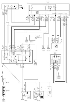

This lead to drop test the control wire on the starter and under cranking with the issue present I have notice there's only 9V at the control terminal of the starter. So am am now trying to trace the ignition control cable from the starter back to the key switch to see where I'm losing the volts.
So far I have managed to chase it to the engine fuse box which passes the connection to the passenger footwell. From here i think it connects to the BSI. Anyone have a diagram of the control wire for the starter motor?

Need your Reg or VIN to get this as there are 2 totally different setups depending on build date. Early models the crank feed is direct off the ignition switch, later models go via the BSM.stephend330 wrote: 12 May 2022, 12:23 Anyone have a diagram of the control wire for the starter motor?

Re: Xsara Picasso Non starter (Single Click in starter motor)
So this is the later setup with Com2000 & BSM.
Yes the BSM is the under bonnet fuse box (PSF1 in the diagram)
The starter circuit is pretty simple.
The Cranking feed comes from pin 3 of the 3 way blue connector of the ignition switch, from here to pin 1 of the 16 way grey connector on the BSM, straight through the BSM & exits on pin 1 of the 2 way black connector and from here straight to the starter solenoid.
The wire number is 100 from start to finish but beware the colour may change as it goes through different units
Thanks for the diagram, will have a look at the car again tonight I get a feeling the cable runs under the dash which will be a little painful to remove I would imagine.

Just volt drop test the wire between the ignition switch & pin 1 of the 16 way green connector on the BSM before you start digging around behind the dash. Repeat the test from there to the starter solenoid, this will narrow down if the voltage loss is before or a after the BSM. It could even be inside the BSM.
stephend330
- Posts: 8
- Joined: 12 May 2022, 12:14
So I have done the volt drop test. At the green connector I'm losing maybe 0.1 so thays good. But between the green bsm pin 1 and the black connector running to the starter control terminal Im seeing 2 volt drop.
Sound like I am losing it in the bsm. Any way to bypass the bsm for testing?
wheeler
- Posts: 7932
- Joined: 21 Sep 2002, 19:07
- x 1056
Direct feed pin one of the 2 pin black straight from the battery, if it starts every time then it looks like a faulty BSM. Just be sure its out of gear when doing this.
Although on the diagram it looks like a direct connection straight in & out the BSM we don't really know what happens inside it.
stephend330
- Posts: 8
Thanks wheeler, turns out i had a few things causing the power drop, There was a repair done on the start cable at some point about halfway in the loom. Was not weather tight so the connection was corroded.
The other was the solenoid on the starter.
combine these caused a 3V drop. Have fixed the connection and replaced the solenoid.
All working now.
