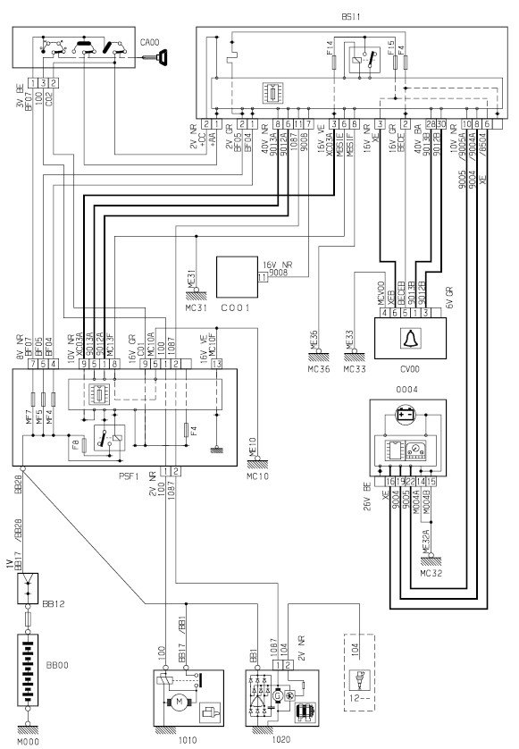

stephend330 wrote: 12 May 2022, 12:23 Anyone have a diagram of the control wire for the starter motor?
Need your Reg or VIN to get this as there are 2 totally different setups depending on build date. Early models the crank feed is direct off the ignition switch, later models go via the BSM.

So this is the later setup with Com2000 & BSM.
Yes the BSM is the under bonnet fuse box (PSF1 in the diagram)
The starter circuit is pretty simple.
The Cranking feed comes from pin 3 of the 3 way blue connector of the ignition switch, from here to pin 1 of the 16 way grey connector on the BSM, straight through the BSM & exits on pin 1 of the 2 way black connector and from here straight to the starter solenoid.
The wire number is 100 from start to finish but beware the colour may change as it goes through different units

Thanks for the diagram, will have a look at the car again tonight I get a feeling the cable runs under the dash which will be a little painful to remove I would imagine.
