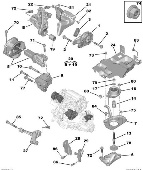

Let me know which numbered items you want parts numbers for:
(1) Anti Torque Link
(5) Engine Mounting Bracket Right
(6) & (7) Engine Mounting Brackets
(9) Engine Mounting Bracket Right
(16) Engine Elastic Mounting Bracket Left
(20) Engine Mounting Bracket Right
(24) Gearbox Support
(27) Power Train Impact Absorber

Could I get part numbers for 1, 16, 19, 20 and 27 as well as the part numbers for the right and left drive shafts (complete). thanks.

Mountings
(1) 1806H0 (NFP) This part is no longer available from Peugeot.
(16) 184468 £78.52
(19) 180940 £38.50
(20) 1807EW £165.17
(27) 189055 £40.12

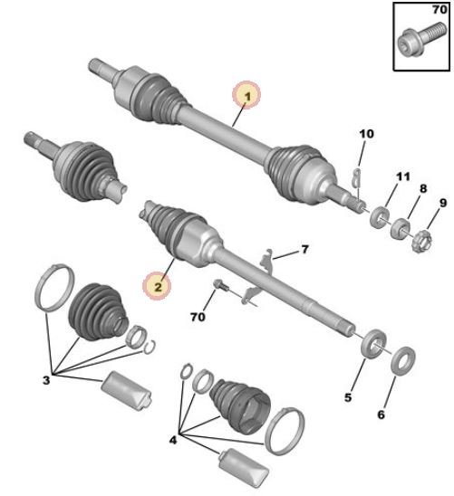

Driveshafts
(1) 3272YY OEM Driveshaft Left £434.42
(1) 3272YZ Exchange Left £253.32
(2) 3273ZT OEM Driveshaft Right £434.42
(2) 3273ZV Exchange Right £253.32
All VAT inclusive from Peugeot as of today.

The front shafts have stickers on them that say PSA 96 719 996 80 and 96 719 997 80. How does this compare to the part numbers above? Can these shafts be changed without resetting the transmission ecu?

Those are the longer international part numbers for your driveshafts. The numbers I provided are the official PSA part numbers which may be either their shorter internal numbers or a number like those you quoted. I can only provide the official ones as listed by PSA for you.

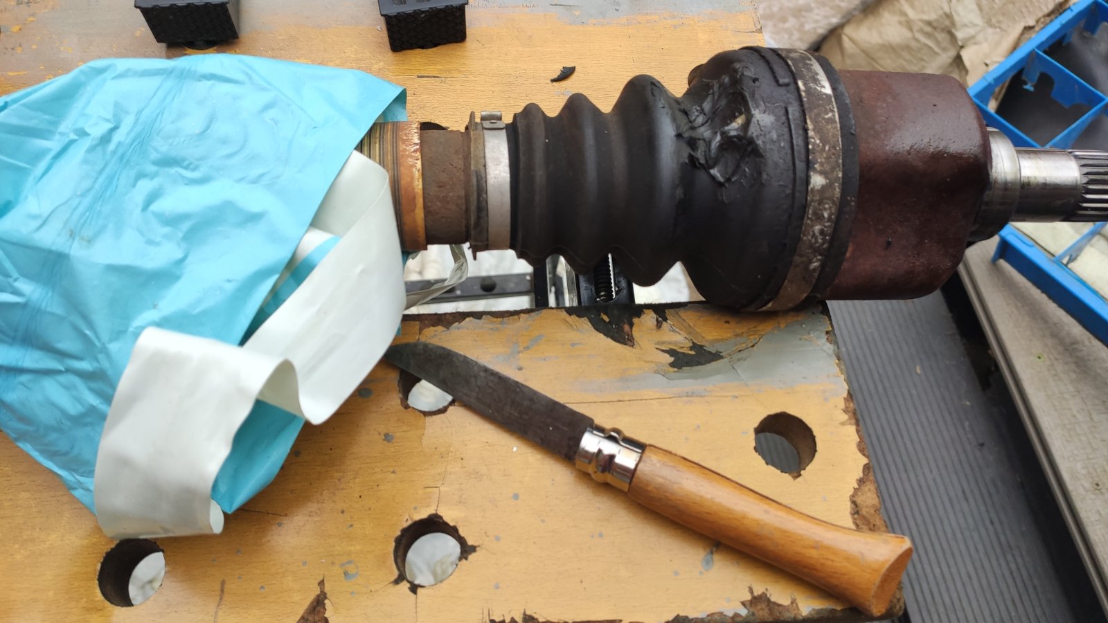

My local garage is reluctant to fit drive shafts claiming the gearbox ecu needs reset if any fluid is topped up.
I suspect my vibration is an inner CV joint on the nsf shaft. I can get a shaft but no one locally wants to work on Hybrids or EVs.

At long last I have been proved right. It was an inner CV joint failure. Probably caused by a clumsy change of broken front springs! Not going to elaborate but I am looking for a reliable garage to do my servicing and MOTs now.
I have put up pictures on my other thread about vibrations elsewhere.
I rebuilt a secondhand shaft for a fraction of the cost of a Peugeot Exchange Unit including importing it from Lithuania! Now that I have done that I now know where to get the bits I needed in the UK, but needs must!
The biggest problem with a lot of Peugeot/Citroen driveshafts is the staked spider joints instead of circlips but, once passed that problem, everything else is straightforward and I rebuilt the shaft quite easily really.
The car is now driving perfectly without the "buckled wheel" feeling through the car. My fault for letting it develop as far as it did, but, in my defence, I have never personally experienced these symtoms before and usually I would have dealt with burst boots long before damage occurred. I just did not find that the boot was cut. The dollop of silicone sealer over the cut disguised it! Not going to elaborate more!
Found this originally when I put my neighbour's son under the car with a camera. Anyone want a chimney swept! Poor lad got no real choice!
