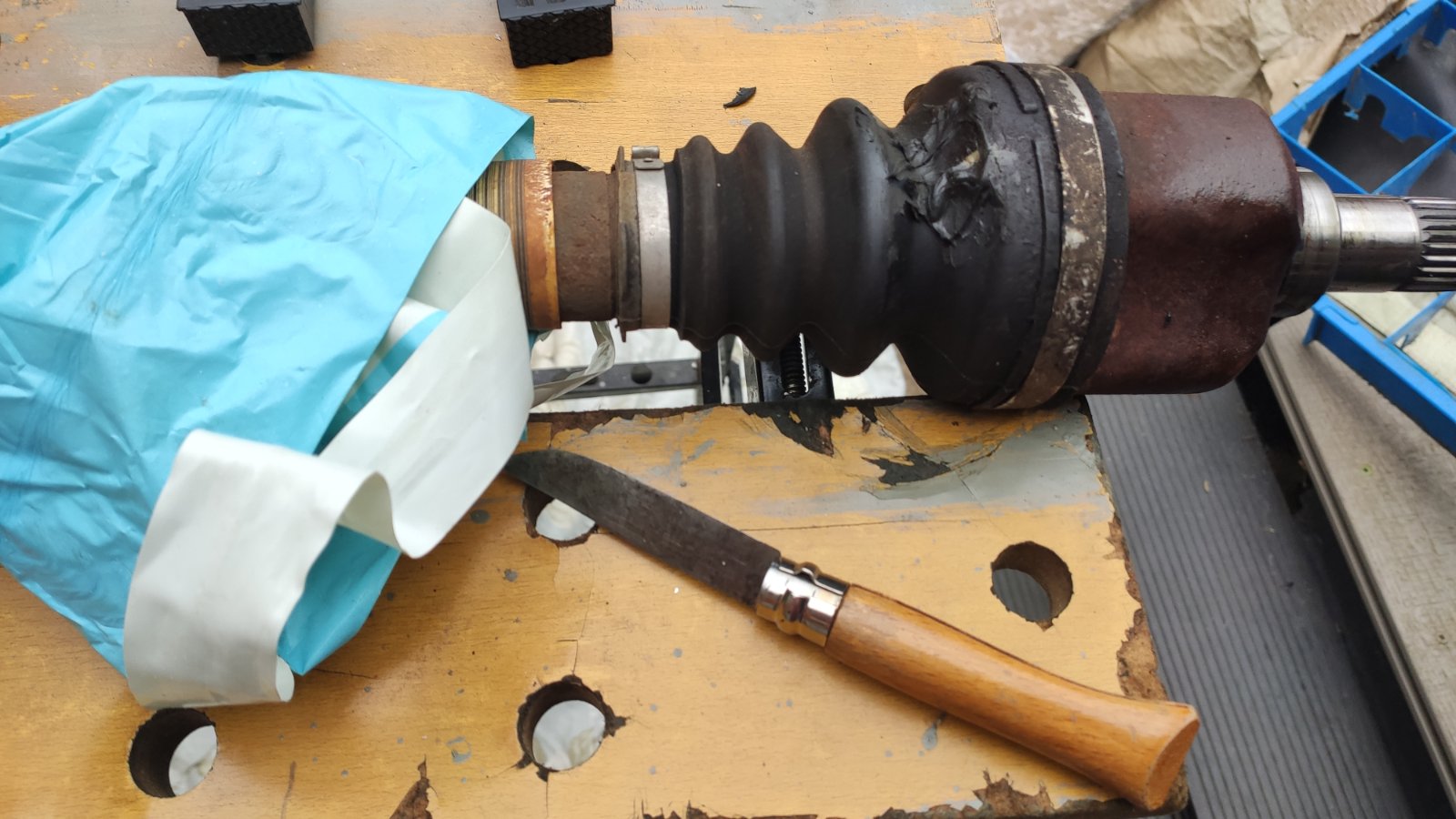

At long last I have been proved right. It was an inner CV joint failure. Probably caused by a clumsy change of broken front springs! Not going to elaborate but I am looking for a reliable garage to do my servicing and MOTs now.
I have put up pictures on my other thread about vibrations elsewhere.
I rebuilt a secondhand shaft for a fraction of the cost of a Peugeot Exchange Unit including importing it from Lithuania! Now that I have done that I now know where to get the bits I needed in the UK, but needs must!
The biggest problem with a lot of Peugeot/Citroen driveshafts is the staked spider joints instead of circlips but, once passed that problem, everything else is straightforward and I rebuilt the shaft quite easily really.
The car is now driving perfectly without the "buckled wheel" feeling through the car. My fault for letting it develop as far as it did, but, in my defence, I have never personally experienced these symtoms before and usually I would have dealt with burst boots long before damage occurred. I just did not find that the boot was cut. The dollop of silicone sealer over the cut disguised it! Not going to elaborate more!
Found this originally when I put my neighbour's son under the car with a camera. Anyone want a chimney swept! Poor lad got no real choice!

Hi. Sorry for the late reply. I got the secondhand shaft through Ebay. I notice that more and more of the later/new style 3008 Hybrids are being broken and their parts look remarkably similar to the first series ones - will need a bit more investigating to see what is the same and what isn't. All of the boots, clips etc were bought off the net. Main dealer prices and availability force you to go to other Peugeot part suppliers, plus their knowledge is invaluable.
I started by stripping the replacement shaft completely down to pieces. Usually the tripod spiders are held on with circlips but these ones were staked in place. I used a Dremel mini grinder tool to remove just enough metal to slide the spiders off and re-staked them back on with a punch when I did the assembly. The parts were all thoroughly cleaned and inspected then re-assembled with high grade CV grease and new boots and clips. To this day I still don't have the part numbers for the individual joints, just the complete shaft. I have just sold the car at 118000 miles and the shaft ran perfectly. It was really just a double CV joint strip down and repack. If you can do a CV joint, you can do this. The only tricky bit is the staked spider splines.
If I find more part numbers or info, I will put it here.
