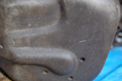

It looks like I will be replacing the gearbox on my wife's car; 207cc, 1.6l vti, 2008.
I've seen other threads showing a position above and to the rear of the clutch slave cylinder/actuator lever as where the box should be marked with the number. I've clean the area and just can't find the number. The other location listed is a label on the end cover; any label is long gone.
Is there another location on the box that is marked?
I understand there are quite a number of variations on the standard box, so I want to make sure I get the correct repalcement from start.
Any help appreciated.

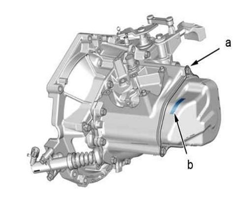

Re: Gearbox number

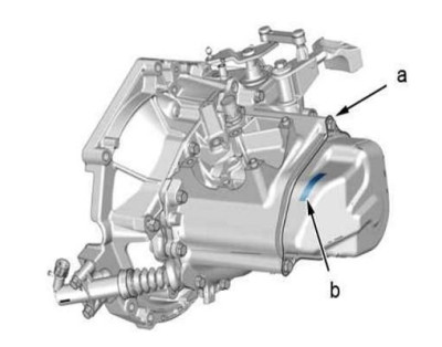

Ok, so here is where the labels should be:
Location of engraving of serial and gearbox numbers (as "a").
Identification label ( as "b").
If this doesn't help, I can provide the PSA part number for you, but this does require a membership upgrade Colin as we have to pay for this service - details below if this would be of use:

Re: Gearbox number

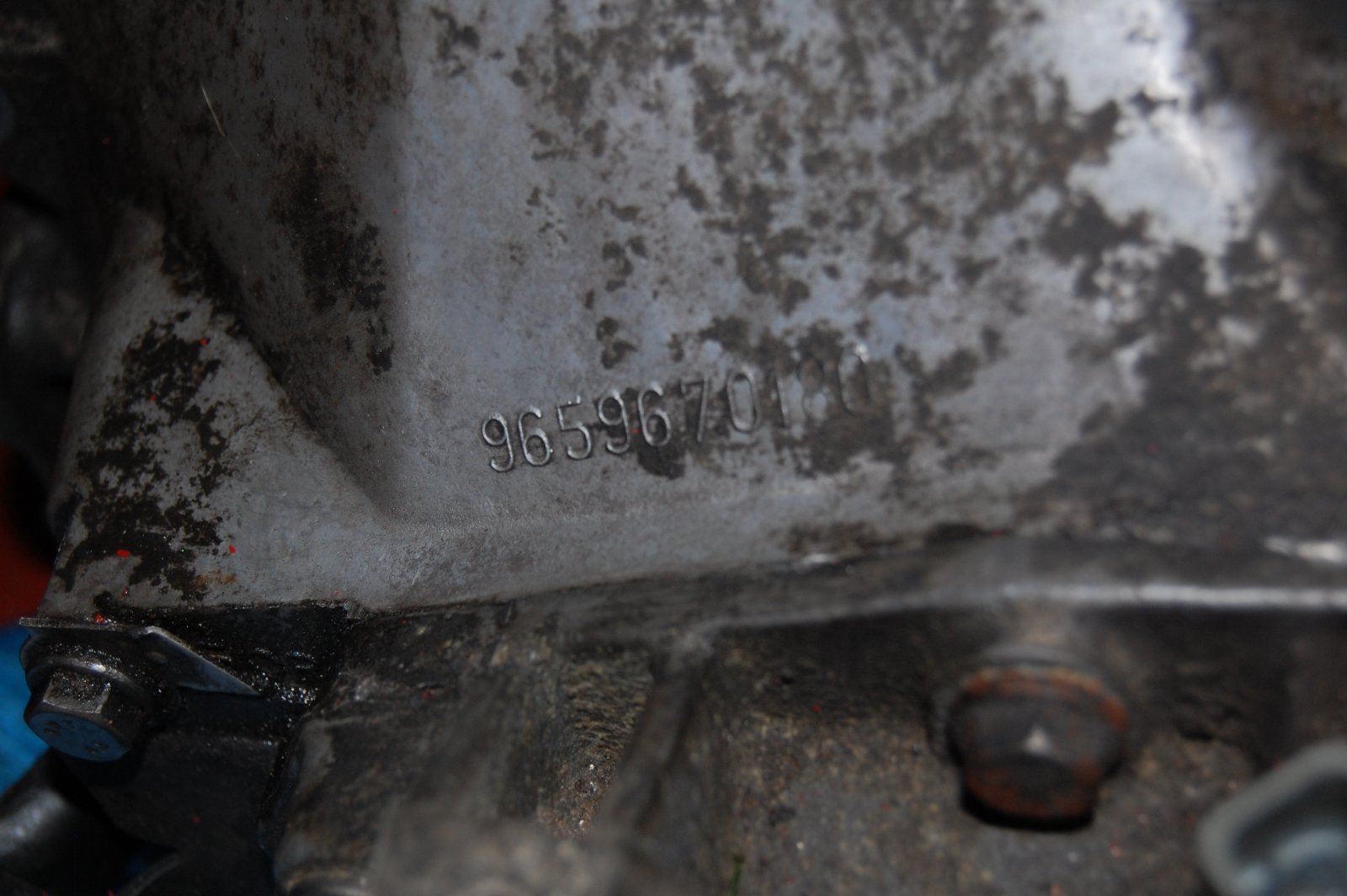

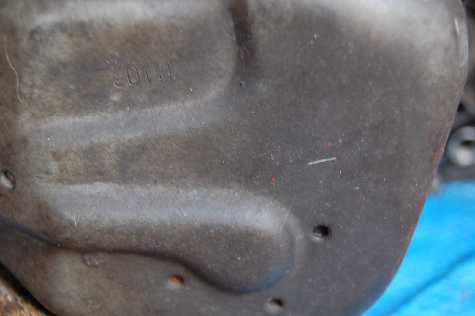

Well got the box off today. 2nd. time in six months, still a big job.
I've checked the location GiveMeABreakStill has suggested but still can't find a number.
The pressed steel end cover has the number HT02 and the bell housing has a cast number 9659670180. Neither of these are anything like what is quoted on various websites.
Any suggestions as to alternative number locations welcome. Looks like I will be going for membership upgrade

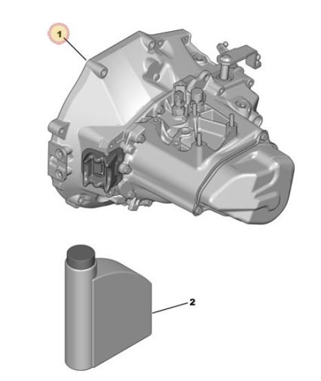

Ok, so Item (1)
Official Peugeot Part number: 223111, Type CP (16X65), with marking CQ46, £5,894.22
Alternatively, Peugeot offer an exchange gearbox, Part: 223274 with marking of either CQ46 or CQD6, £1895.06
All VAT inclusive direct from Peugeot.
So hopefully you can locate the correct box on the aftermarket now.
One here:
https://www.proxyparts.com/car-parts-st ... /14198726/
Ok, so Item (1)
One here:

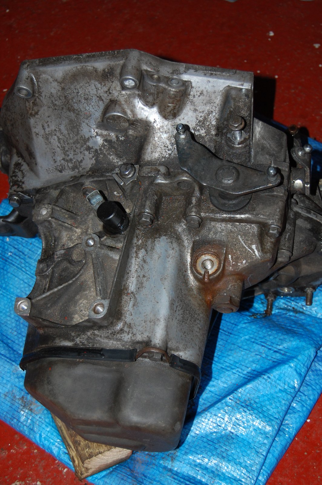

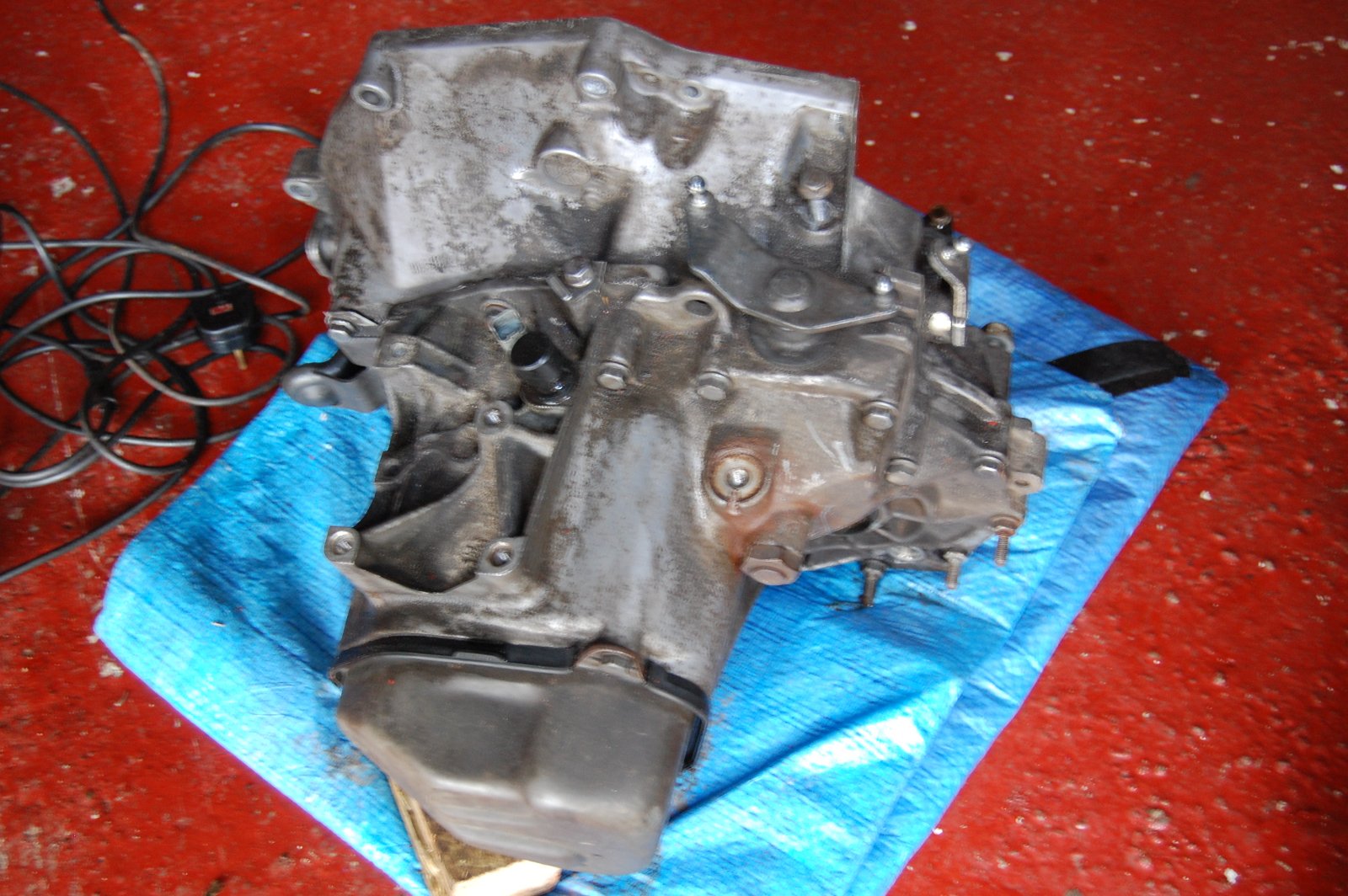

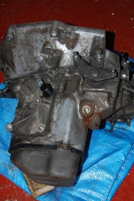

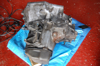

Well got a replacement gearbox from a scrappy, delivered to the door today.
Stripped off the surplus parts and gave it a good clean and found the pattern number and the unique box number. So I went back to the original box and found the numbers. When I say found, I of course mean I scrubbed the area with strong detergent, degeaser and a wire brush on a drill and eventualy found them. For these boxes the location seems to be on the bellhousing above the anti-torque bracket at the bottom of the box. On the replacement box well marked (20CQ46, 203695) and easy enough to find, on the original, poorly marked (20CQ46, 1050008?) and I'm not sure I have the correct unique number. I will have to make sure I get it because;

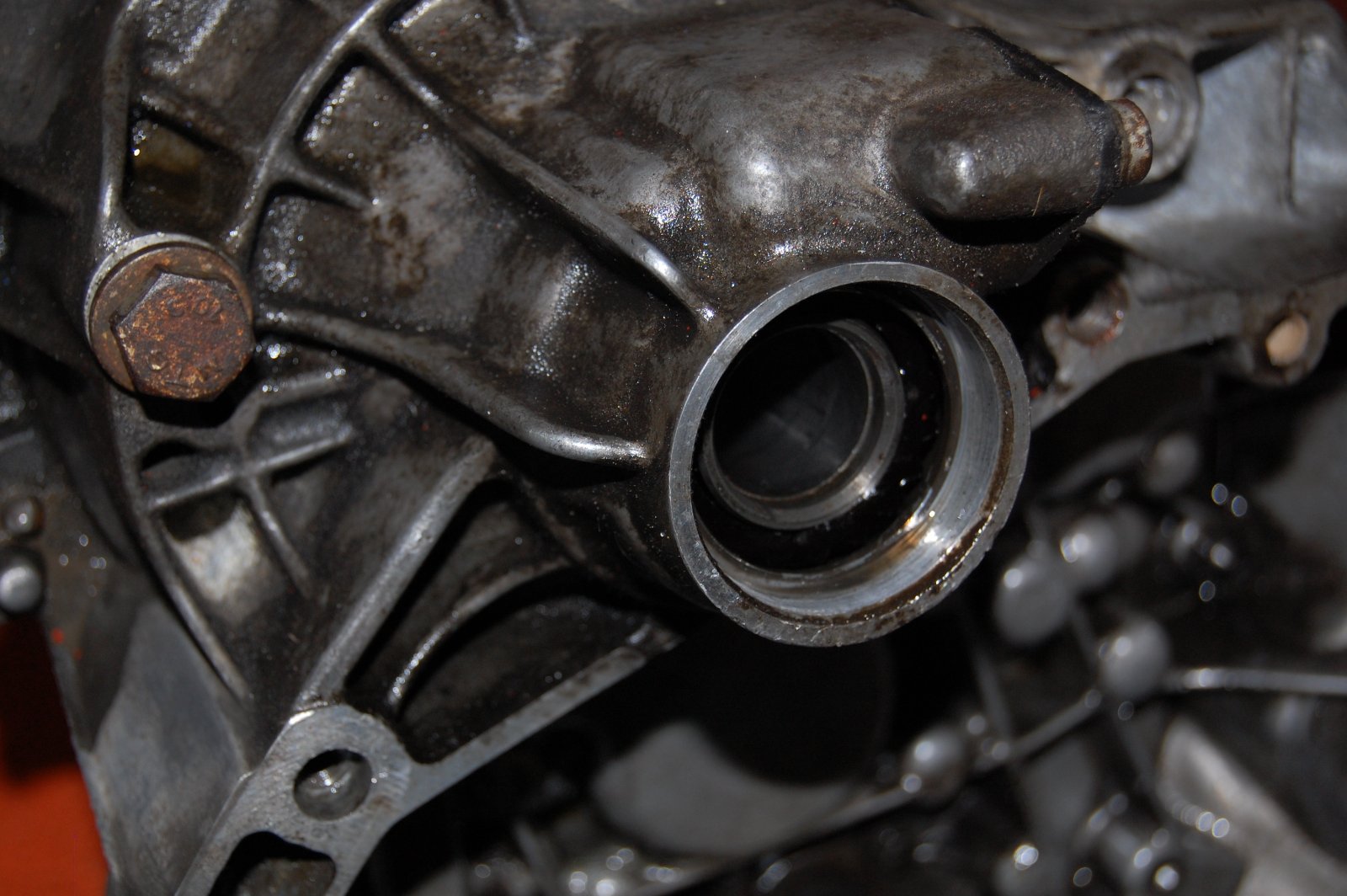

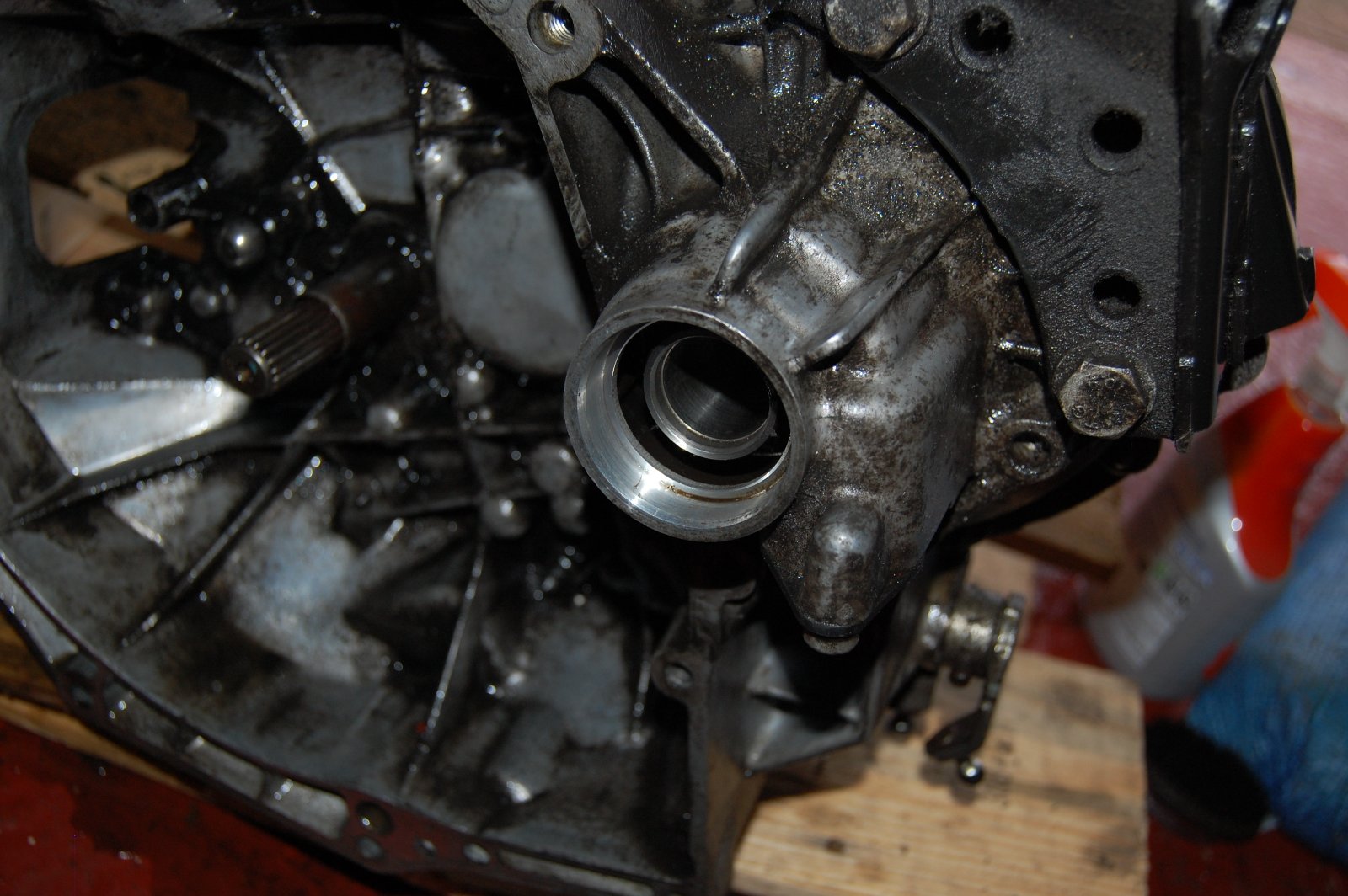

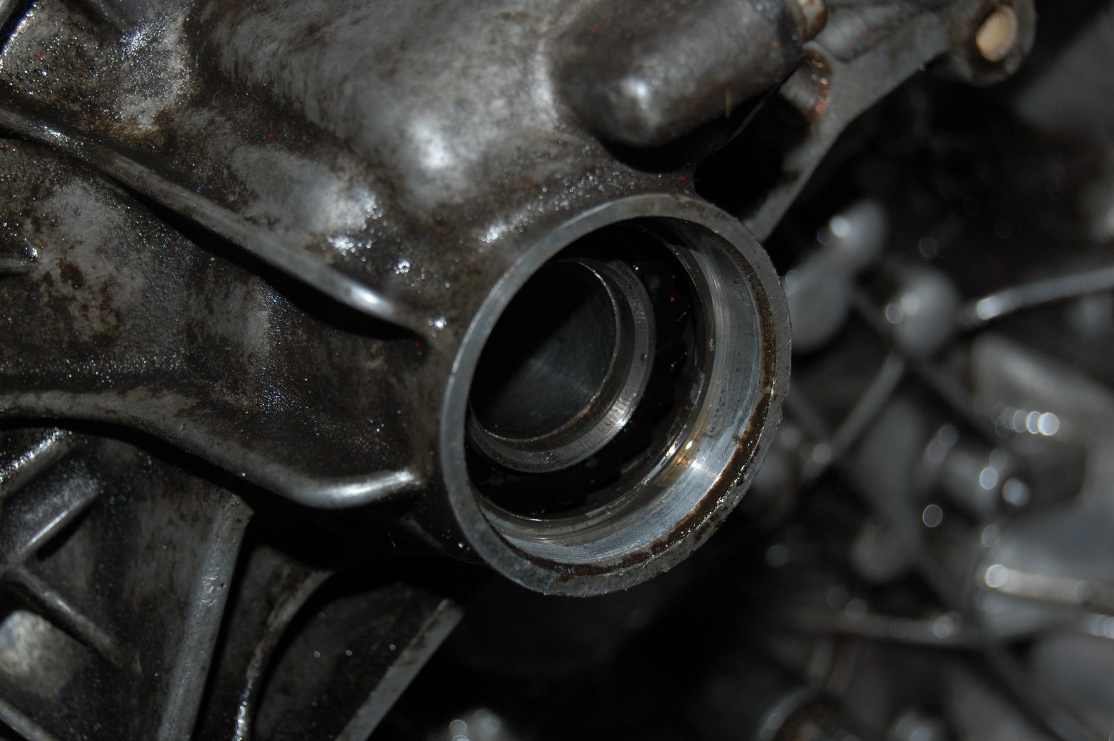

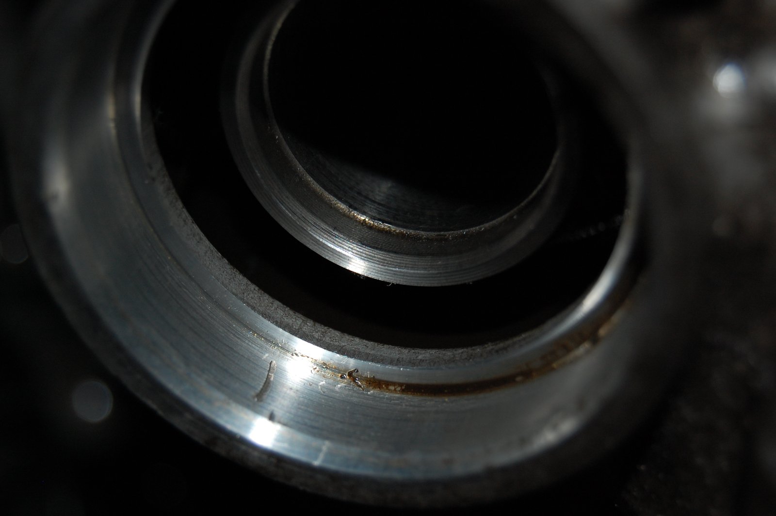

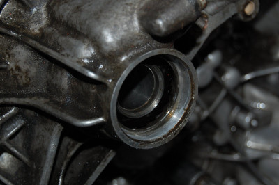

I intent to fit new driveshaft seals, got them from a Peugeot dealer, but when I made a close comparison between the two boxes found a small difference. The seal housings are ok but behind the seal landing, inside the original box, is what looks like a floating plastic ring with the outer circumfrance segarated/raggaed edge. I've tried to take photos but the camera found the close foucus hard.
I would appreciate any advice on this. Maybe someone has come across this before and can say if this is important or not. I'll be going back to Peugeot tomorrow but not sure what sort of welcome I'll get when I start talking about gearboxes from a scrappy.
The black ring you see in the Original Box 1 & 2 is the plastic ring.
The black ring you see in New Box 1 & 4 is just deep shadow, there is nothing there.
![Image]()

Re: Gearbox number
I cant really see it properly but if its a plastic gear it may be for a road speed sensor, you car more than likely wont need it as the speedo info will probably come via the ABS system. Some gearboxes still seem to have the drive gear fitted or it may be from an older car. there is normally a blanking plug in place of the speed sensor now.

Re: Gearbox number
The only electrical switch fitted is the reversing switch, so an inactive speed gear is a possibility. My first thought was some sort of oil seal or splash guard to protect the main external seal. But on, that both boxes had the same style/shape seals, so I would assume they are factory fitted. The new seal from Peugeot is slightly different in appearance and is the updated version as the original is no longer supported.
Eitherway it will now be tomorrow before I can get time to give it a good look.
Colin2206
- Posts: 105
- Joined: 31 Oct 2019, 11:31
- x 19
Re: Gearbox number
Well wheeler you called it correctly. I had a good look at it and there is a blanking plug above it and with it removed I can see it is a plastic helical gear.
