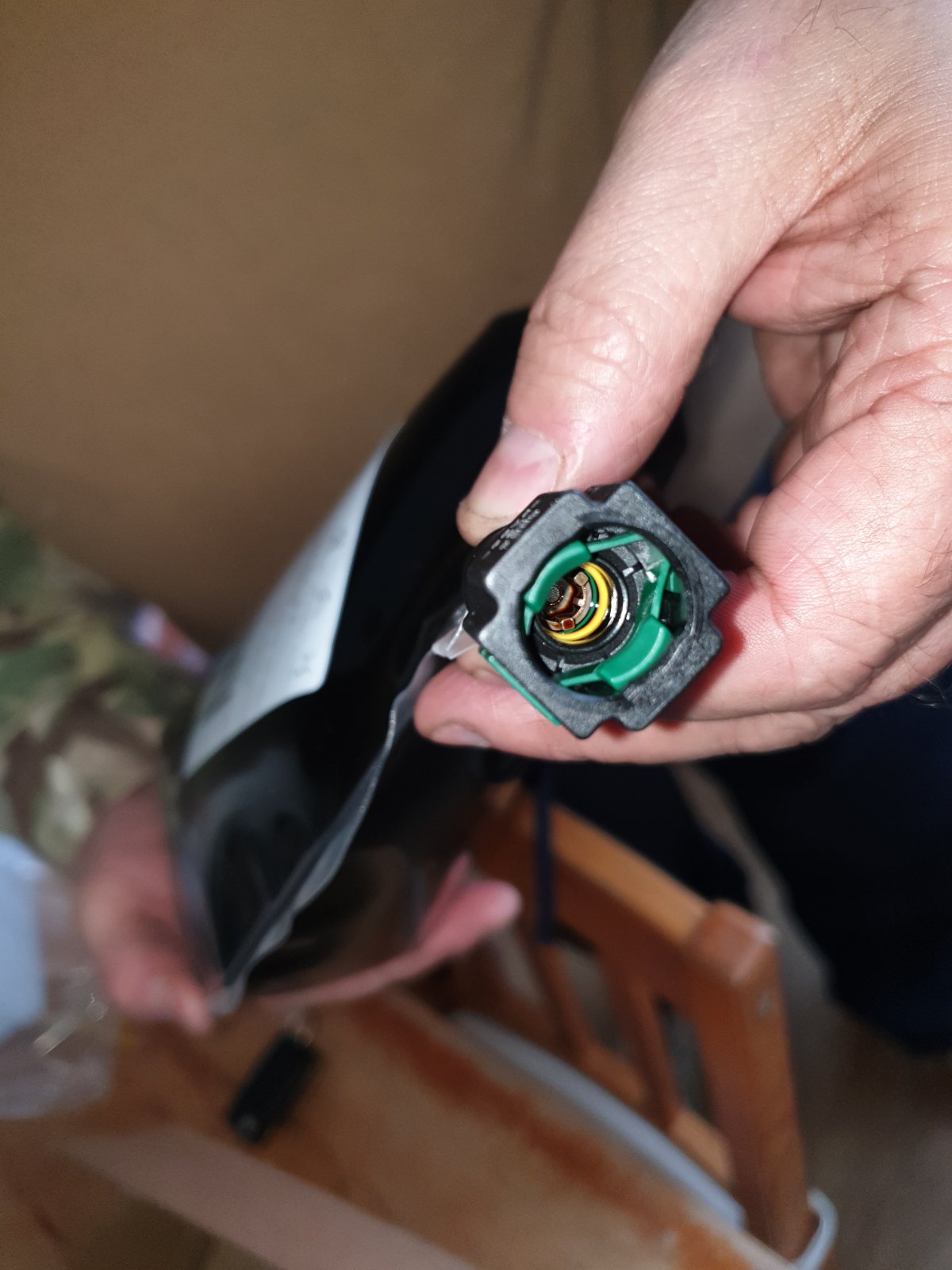

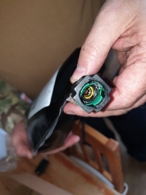

This may sound like a silly question but in the "throat" of the connector from the bag of Eolys, there looks to be a bung/stopper that stops any fluid leaking out during transit. Does this remain in the connector and I just fit the bag in or am I supposed to retrieve it?

It should just fit into the 'click-fit' connector when you fit it back into the additive support unit.

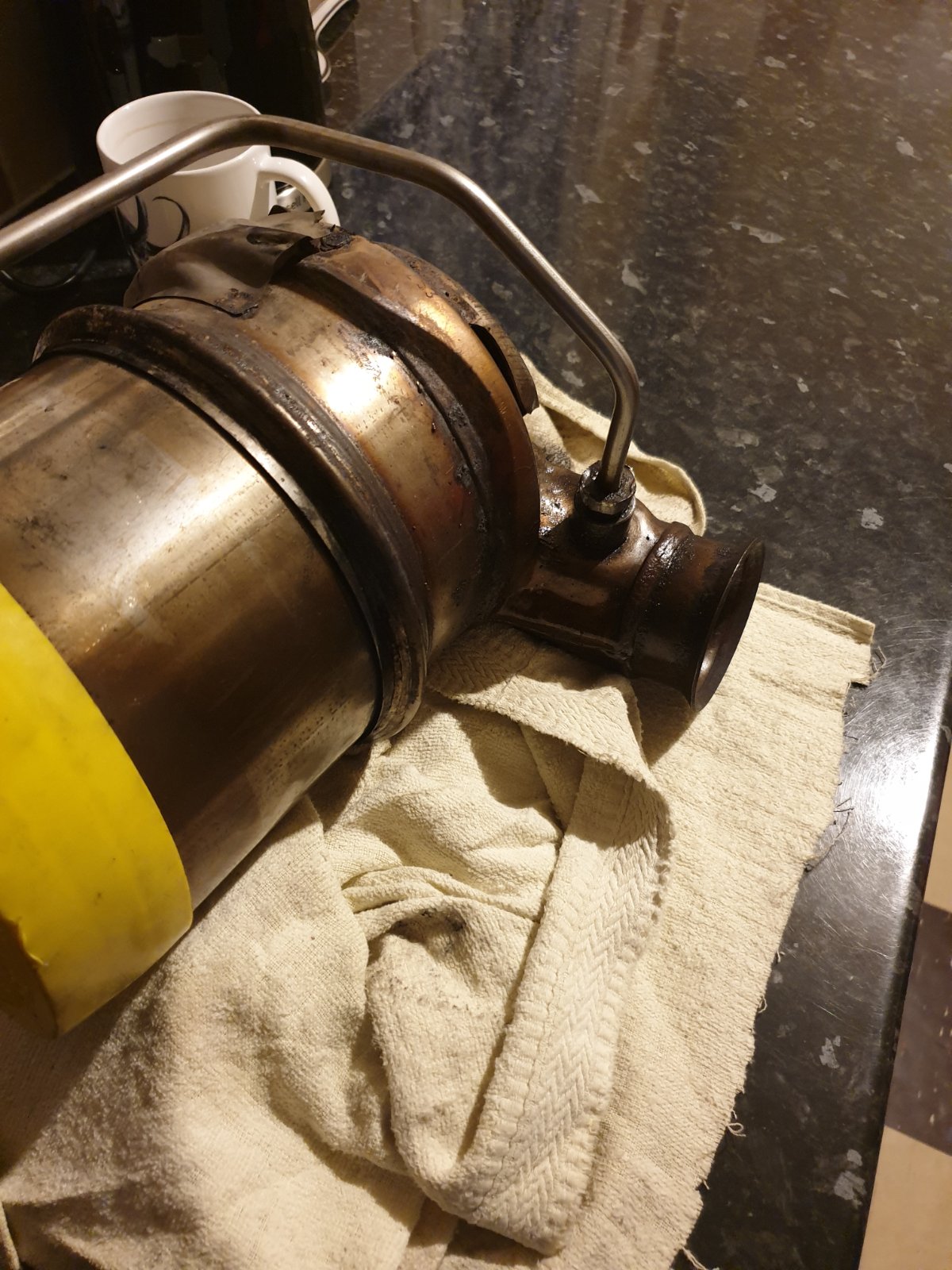

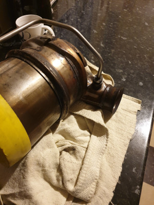

Has anyone ever had the lower dpf pressure pipe bolt seize up inside the fitting and did anyone managed to remove it without damage to the dpf? Please could I ask how you managed it.
I have so far tried butane gas torch, followed by wd 40, the 19mm spanner i thought was turning it only to find its rounding it. Mole grip not doing anything and I really dont want to damage the old dpf.
Helpful advice gratefully recieved

**Solved and sorted** car running okay, no errors any longer, managed to weld metal to nut of dpf pipe and remove successfully from the car.

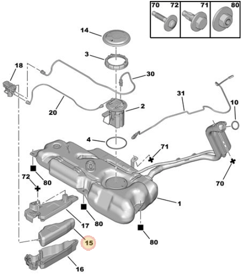

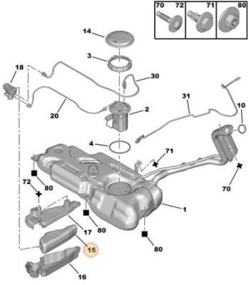

Item (15) Flexible Additive Pouch, (Powerflex), part: 9678033680, £175.06 inc. VAT direct from Peugeot, or you can search on this part number on the web for possible cheaper sources, but be aware you will also need to reset the additive counter with a professional level diagnostic tool like Diagbox.
