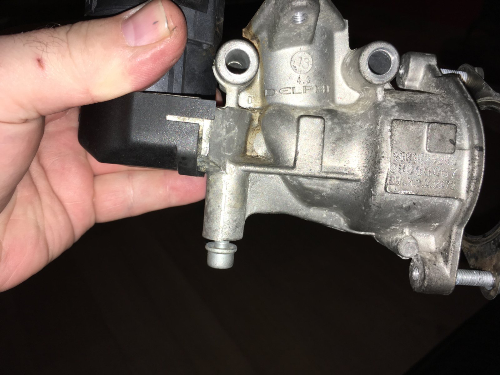

osx
- Posts: 770
- Joined: 08 Jun 2013, 20:09
- x 15
Re: C5 X7 Emissions
C5 X7 Exclusive 2.0 HDi Auto
Steve Walsh
- Posts: 777
- Joined: 25 Oct 2019, 07:20
- x 518
Re: C5 X7 Emissions
It hasn't got DELPHI embossed on casting
