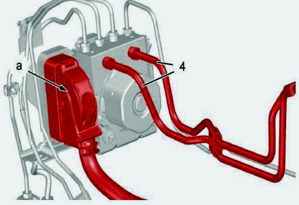

Help!! Just where is the ESP/ ABS unit on my 2015 Grand Picasso?
I have an open circuit wire from rear left hand wheel parking brake actuator motor.Not the usual wire break near the wheel arch but somewhere between the ESP and the connectors beneath the rear seat.I have spent 2 days trying to get wiring diagrams(wasted £26 buying a Haynes online manual which was totally useless) I am down to tracing wires by colour , blue with white stripe on this case but where is the ESP unit? I have removed both front wheels and inner mudguards but there is nothing there.Help anyone?

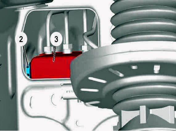

The ESP unit is combined with the ABS system. The ECU is part of and sits on top of the hydraulic brake block. On this vehicle is it located behind the driver's side wheel arch, but is hidden inside a compartment. There is not much access and you may not be able to check the ECU without removing the entire block - which means scuttle, windscreen surround, under engine shielding off to get to:

Thanks. I have located it but rather than being under the wheel arch it is on the bulkhead in the corner behind the engine on the drivers side.!! Can barely reach it with fingertips so it is beginning to look like an engine out .job.Anyone else had any dealings with this.It seems a crazy place to put an electrical module.

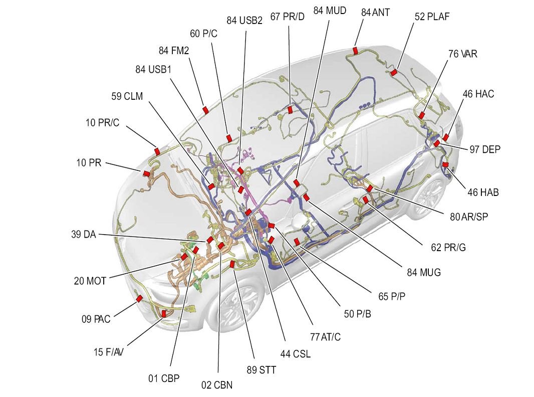

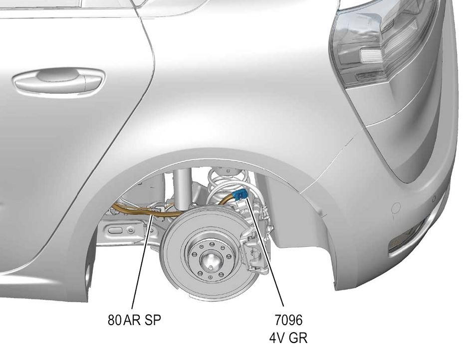

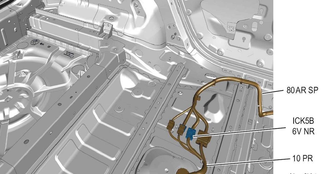

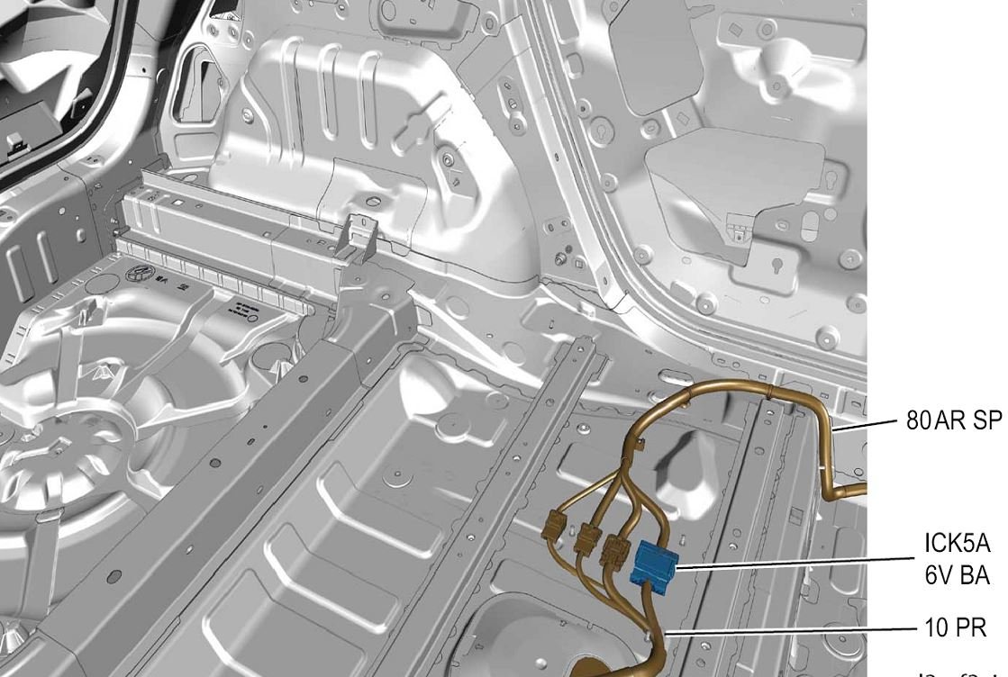

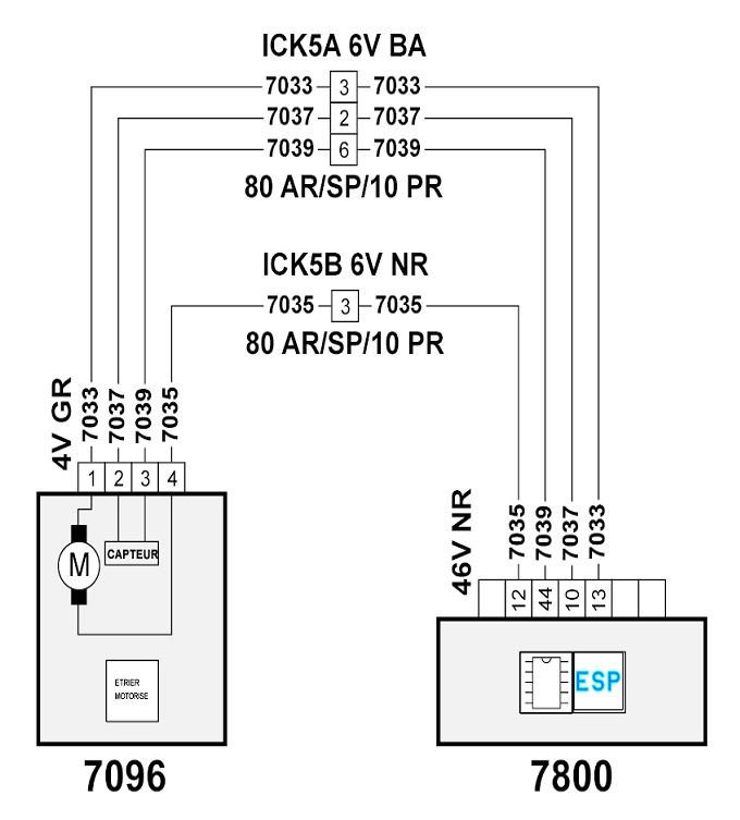

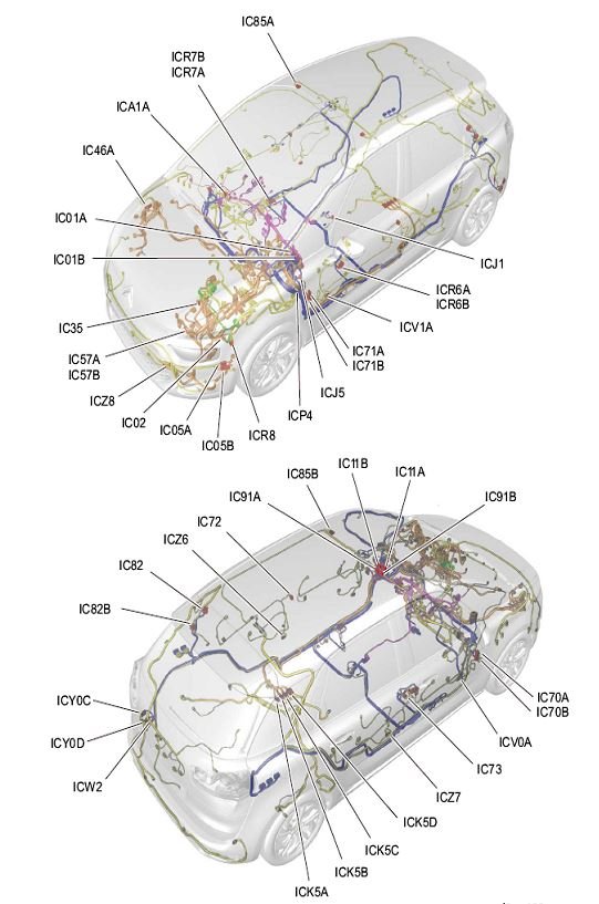

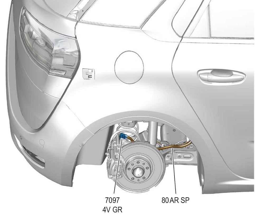

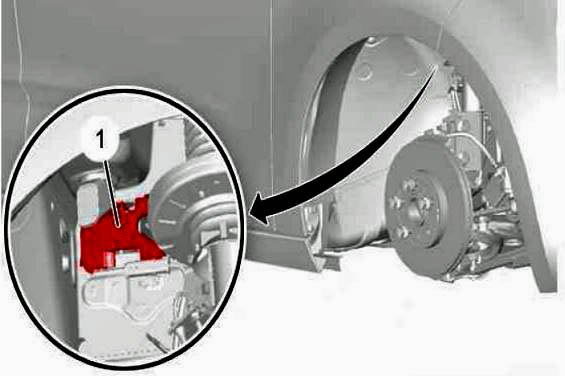

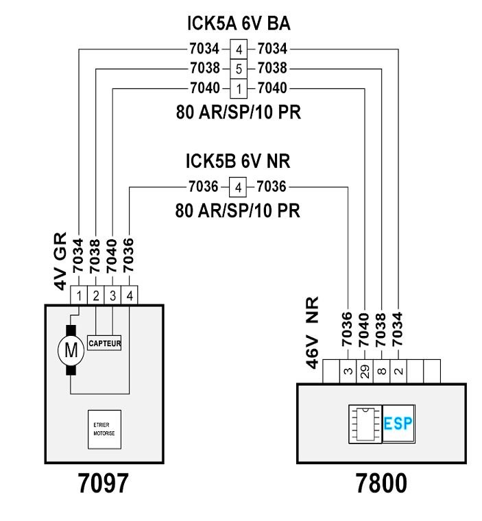

OK, unfortunately, I only have a few pictures of the general locations of the harnesses and the interconnections, but as for the wiring, no codes for the wires, so I can't tell you the designations.
These may help you:
Click on the smaller images to magnify them.
Main Wiring Diagram for the Parking Brake, but it shows you the motors on the calipers (7096 - rear left & 7097 - rear right).
This is the same, but the wiring connections to the harnesses and interconnections
These are the locations
These may help you:
| Harness Locations | Interconnections Locations |

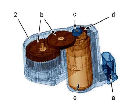

I can't tell you which wiring code is which unfortunately on this model, but if there is a fault with one of more of the caliper motors, I suspect a replacement may be necessary as everything is internal to the units:
These are the wiring functions of the 4 way connectors:
But, the wiring can be identified from the plug here:

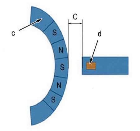

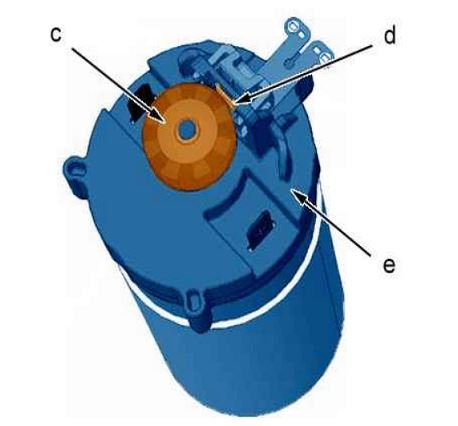

As for the sensors, they use a magnet and detecting cell very much like the ABS system to determine whether the handbrake is in application or the release phase.
The position sensor of the electric motor of the motorised caliper consists of an element that is sensitive to the changes in magnetic field of the target "c" and a detector cell that generates the electrical output signal "d".
"C" Air gap.
"N"North.
"S" South.
"c" Magnetic target.
"d" Detecting cell.
The position sensor of the electric motor receives a magnetic frequency sent out by the magnetic target "c".
The succession of north and south poles from the target switches the electrical output from the sensor, indicating whether the phase is application or release.
Hopefully this will give you a better understanding of the operation.
| Number of channels | Allocation of the tracks of the connector |
| 1 | Supply of the electric motor of the motorised caliper |
| 2 | Signal (+) from the position sensor of the electric motor of the motorised caliper |
| 3 | Signal (-) from the position sensor of the electric motor of the motorised caliper |
| 4 | Earth |
| (2) Motorised caliper motor. "a" 4-way black connector. "b" Gear wheels. "c" Magnetic target. "d" Detecting cell. "e" Electric motor of the motorised caliper. |
