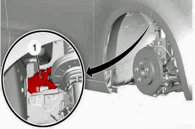

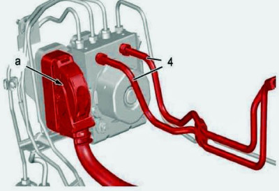

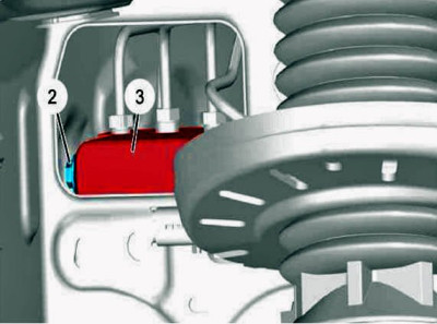

The ESP unit is combined with the ABS system. The ECU is part of and sits on top of the hydraulic brake block. On this vehicle is it located behind the driver's side wheel arch, but is hidden inside a compartment. There is not much access and you may not be able to check the ECU without removing the entire block - which means scuttle, windscreen surround, under engine shielding off to get to:

Thanks. I have located it but rather than being under the wheel arch it is on the bulkhead in the corner behind the engine on the drivers side.!! Can barely reach it with fingertips so it is beginning to look like an engine out .job.Anyone else had any dealings with this.It seems a crazy place to put an electrical module.

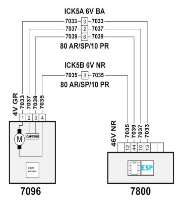

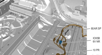

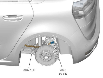

OK, unfortunately, I only have a few pictures of the general locations of the harnesses and the interconnections, but as for the wiring, no codes for the wires, so I can't tell you the designations.
These may help you:
Click on the smaller images to magnify them.
Main Wiring Diagram for the Parking Brake, but it shows you the motors on the calipers (7096 - rear left & 7097 - rear right).
This is the same, but the wiring connections to the harnesses and interconnections
These are the locations
Harness LocationsInterconnections Locations

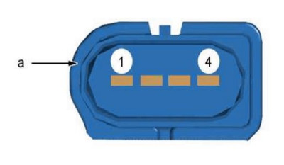

These are the wiring functions of the 4 way connectors:
Number of channelsAllocation of the tracks of the connector
1Supply of the electric motor of the motorised caliper
2Signal (+) from the position sensor of the electric motor of the motorised caliper
3Signal (-) from the position sensor of the electric motor of the motorised caliper
4Earth
But, the wiring can be identified from the plug here:
