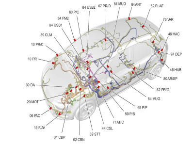

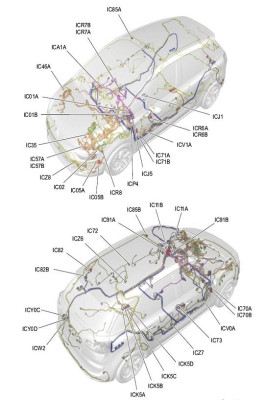

Re: Grand Picasso parking brake wiring fault.
OK, unfortunately, I only have a few pictures of the general locations of the harnesses and the interconnections, but as for the wiring, no codes for the wires, so I can't tell you the designations.
These may help you:
Click on the smaller images to magnify them.
Main Wiring Diagram for the Parking Brake, but it shows you the motors on the calipers (7096 - rear left & 7097 - rear right).
This is the same, but the wiring connections to the harnesses and interconnections
These are the locations
These may help you:
| Harness Locations | Interconnections Locations |

Thanks again Marc.I will have a go at getting the multipin connectors out of the ABS unit to check the continuity of the suspect wire.
