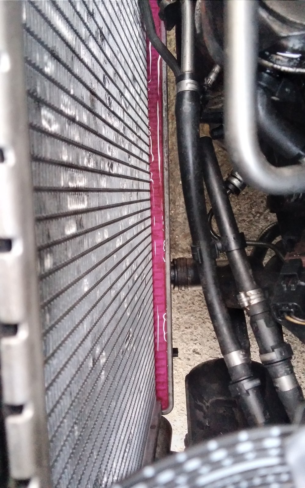

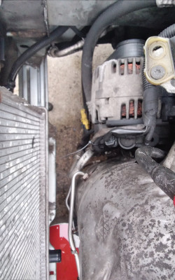

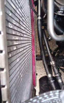

The dpf pipe somehow came off its fixture and did the damage so today modified the pipe work with much better clearance .
Trouble is rad leaks like a tap , ive taken measurments of my fitting area and ive got as follows
Rad measure 206cc
470 heigh
340 mm width between pegs ,390mm on cowling¹ possible 400mm... these are rough but almost true. If theres any diagram with measurements that would be helpful
Rad measure 206cc
470 heigh

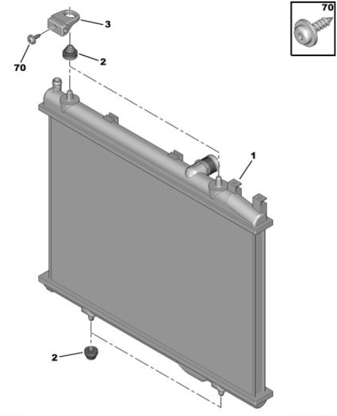

Im seeing different rads , would you have dimensions at all for the size needed, im trying to source an after market type.GiveMeABreak wrote: 19 Dec 2021, 10:26Radiator:Huskyxantia wrote: 19 Dec 2021, 09:35 Needing the correct number for a radiator water one for my 206cc 1.6hdi. Thanks in advance..
OEM Original part: 1330N2, £429.06
Peugeot Exchange Radator: 133356, £268.68
Husky.
- x 6956
Re: Citroen and Peugeot Parts Requests
Unfortunately not. PSA have not provided dimensions anywhere for the rad. Either part number would be the correct one - and as there are no other variants (like say in the case of an alternator where there can be 20+ in some cases), they would have no need to publish the sizes. So you'll have to use the measurements from the existing one to cross reference it with.
This is invariably the issue with aftermarket parts - they may have different dimensions so can be trial and error - but reduce the incompatibility by ensuring you search on 1330N2 and look to find ones in the search that have similar dimensions to each other. If it goes toes up and doesn't fit, at least you have good reason to send it back.

Well 5mm to wide .. oh well no car till next year unless my pal turns up later to help line my picasso gears up.Huskyxantia wrote: 22 Dec 2021, 10:22 My replacement rad is due this morning ! I'm watching the tracking live and waiting with baited breath !
At least the picasso has a spare rad...,ive just checked this new rad is all the same as the picasso!
