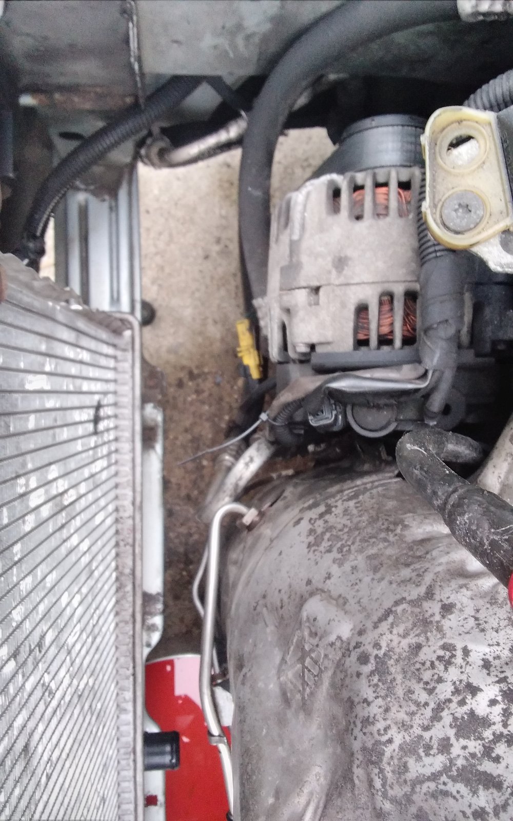

The dpf pipe somehow came off its fixture and did the damage so today modified the pipe work with much better clearance .
Trouble is rad leaks like a tap , ive taken measurments of my fitting area and ive got as follows
Rad measure 206cc
470 heigh
340 mm width between pegs ,390mm on cowling¹ possible 400mm... these are rough but almost true. If theres any diagram with measurements that would be helpful
Rad measure 206cc
470 heigh
