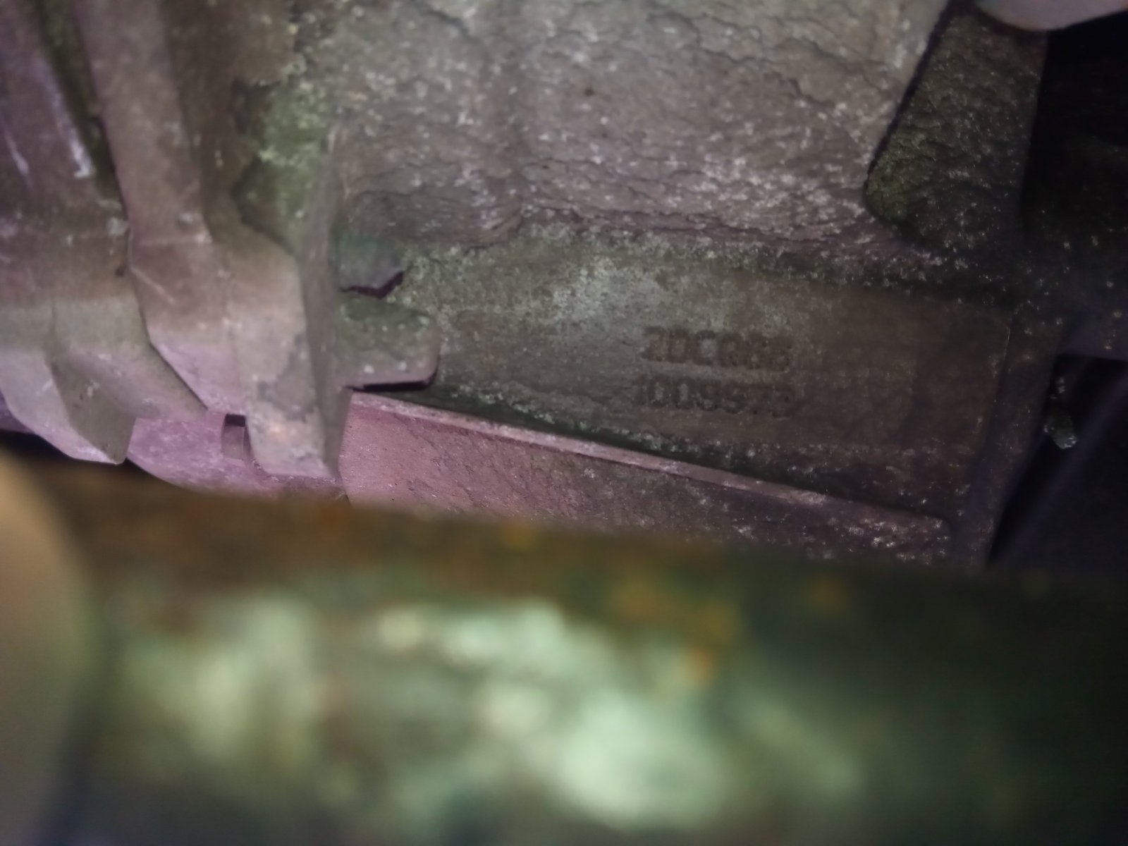

The gearbox is numbered "20CQ88" and the question is whether or not this defines the gearbox completely or may that number represent gearboxes with different ratios.
The reason for the question is that there are plenty of used ones that are from petrol cars but few from diesels. I tried asking a few sellers but no one seems to know and neither does the Internet in general.

Apparently this car left the factory with a CQ66 gearbox.
There's food for thought. It seemed fine with the CQ88. Maybe I read the number wrong last time I had it out.

Your photo shows a ....66, if I read it right.
Is that the box in the car now?

Yes, that is from the one in the car.
You reckon it is 66 then. I still reckon it is 88 but I suspect you are right. I got the number from the box, not a picture but looking at other pictures on the Internet you are probably right I think.
Thinking about it it is bound to be 66 because my luck runs that way. 66 is at least £250 used, 88 is half that.
I feel a repair coming on.

It is definitely a CQ 66! And that is exactly what some of the DV4C engines are fitted with.... there are NO CQ 88 boxes fitted to 1.4 HDi A51 C3s.

So
20CQ66 is casting shape and final drive ratio.
1009973 is internal gear ratios.
Correct?
Correct?

Not sure where you are getting 1009973 from....

Off the picture up there ^^^^^^.
- x 6947
Re: 20CQ88 gearbox in 2011 C3 1400 diesel
That's probably the gearbox serial number.
