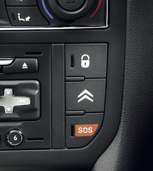

If you don't have the button with the SOS or Citroen logo on, then you won't have it:

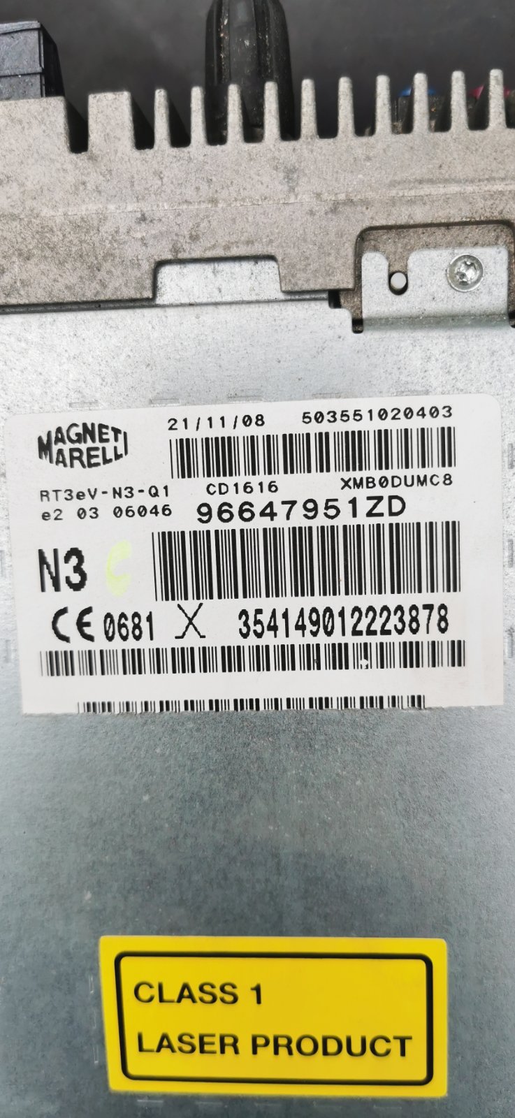

So, i finally got the unit. It turns out the seller doesnt make the difference between rt3 and rt5.. he sent me rt3ev-n3-q1. Which i think doesnt have bluetooth. In which case the whole swap lose any meaning.. im attaching a pic of the units label.
- x 6955
Re: RNEG swap to RT5
Hi, yes, that is the model code for an RT4 which was fitted to early C5 X7s. It does not have Bluetooth (it will have a SIM card slot on the front).
