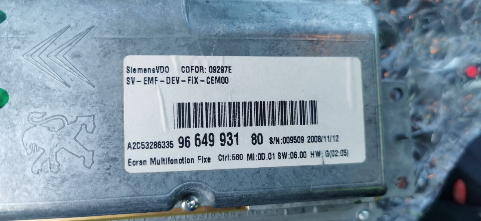

Anyway, im attaching a photo of the display label. From whatever info i could find, its used also in rneg systems, which leads me to believe its not high-res
Im currently waiting for him to uninstall the cd plus all the cables and send it to me.
Which brings me to a question. The rt5 unit has 4 colored cables on the back, two radio antenas, one gps antena and one gsm antena i guess. And my rneg has three of these (im guessing minus the gsm antenna). So from the donor car i need only the unit and the gsm antenna? Cause the other cables goes all the way to the trunk and its a bit overwhelming to take down
As you already mentioned, its a straight swap, so im hoping only the gsm antenna needs to be added.

You have to remember that the RT5 is OLDER that the RNEG!

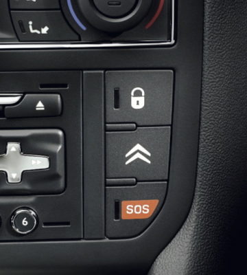

If you don't have the button with the SOS or Citroen logo on, then you won't have it:

Re: RNEG swap to RT5
I understand that this is the case with my current setup. But isnt there an SOS button on the rt5 unit itself? If thats the case, can the gsm function be activated after installing the aerial?

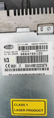

So, i finally got the unit. It turns out the seller doesnt make the difference between rt3 and rt5.. he sent me rt3ev-n3-q1. Which i think doesnt have bluetooth. In which case the whole swap lose any meaning.. im attaching a pic of the units label.

Hi, yes, that is the model code for an RT4 which was fitted to early C5 X7s. It does not have Bluetooth (it will have a SIM card slot on the front).
