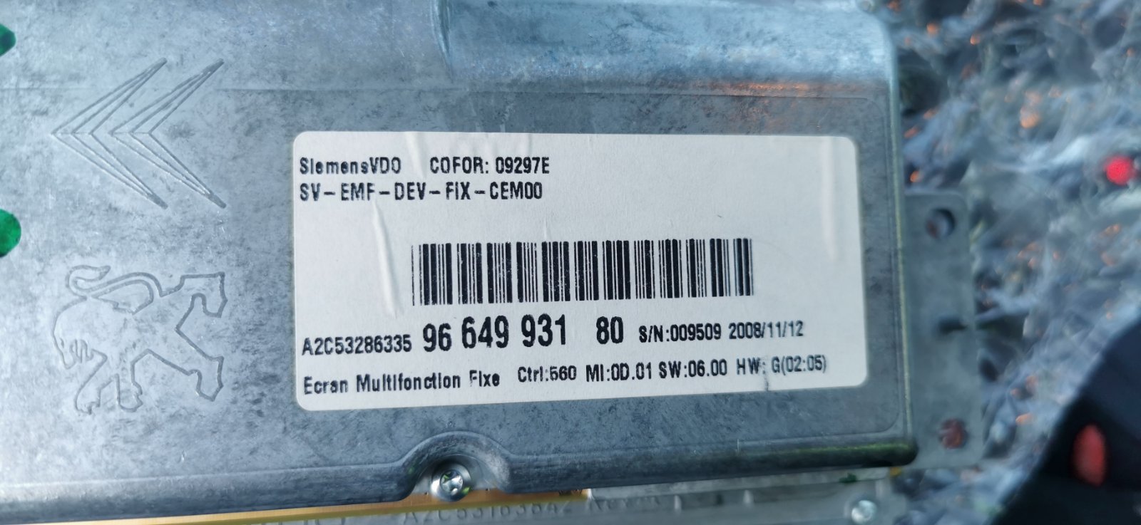

Anyway, im attaching a photo of the display label. From whatever info i could find, its used also in rneg systems, which leads me to believe its not high-res
Im currently waiting for him to uninstall the cd plus all the cables and send it to me.
Which brings me to a question. The rt5 unit has 4 colored cables on the back, two radio antenas, one gps antena and one gsm antena i guess. And my rneg has three of these (im guessing minus the gsm antenna). So from the donor car i need only the unit and the gsm antenna? Cause the other cables goes all the way to the trunk and its a bit overwhelming to take down
As you already mentioned, its a straight swap, so im hoping only the gsm antenna needs to be added.

Re: RNEG swap to RT5
You have to remember that the RT5 is OLDER that the RNEG!
The RT5 has emergency calling and uses a SIM Card (it should have a vertical slot on the right hand side of the head unit) so needs a GSM aerial to work with it. The RNEG does not - it is Bluetooth only, but if the vehicle with RNEG (MyWay) is fitted with emergency service option like an independent telematic unit - that will be integrated into the car and hidden with it's own aerial separate to the Head unit so that it can automatically send location information to the emergency services in the event of a bad accident that triggers the airbags, or for emergency contact when you hit the red SOS button.
