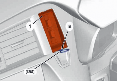

You will need a set of these keys - that you can buy cheap enough off ebay or other places - they are the same ones used for removing some Head Units.
First you should disconnect the battery following the relevant part of this guidance: BSI Reset / Battery Disconnect / Reconnect Procedure
Refitting
Proceed in the reverse order to removal.
Reconnect the battery following the reconnection part of the BSI Reset / Battery Disconnect / Reconnect Procedure
Check the operation of the equipment.

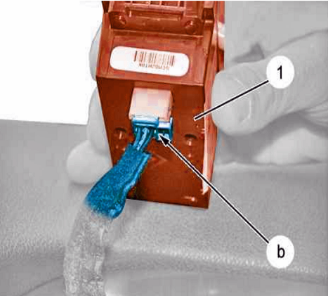

| Unclip the analogue clock (1) (at "a") using tool [1287]. Detach the analogue clock (1). | Disconnect the connector (at "b"). Remove the analogue clock (1). |

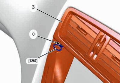

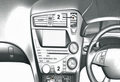

Remove:

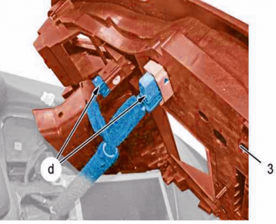

| Unclip the multifunction control panel (3) (at "c") using tool [1287]. Detach the multifunction control panel (3). |
| Disconnect the connectors (at "d"). Remove the multifunction control panel (3). |
