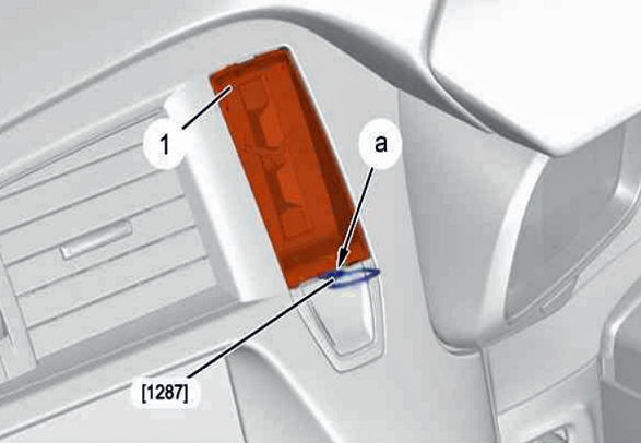

You will need a set of these keys - that you can buy cheap enough off ebay or other places - they are the same ones used for removing some Head Units.
First you should disconnect the battery following the relevant part of this guidance: BSI Reset / Battery Disconnect / Reconnect Procedure

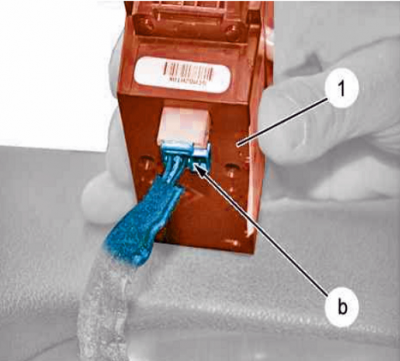

Unclip the analogue clock (1) (at "a") using tool [1287].
Detach the analogue clock (1).
Disconnect the connector (at "b").
Remove the analogue clock (1).

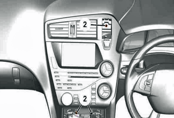

Remove:
  • The upper trim of the central console
  • The bolts (2)

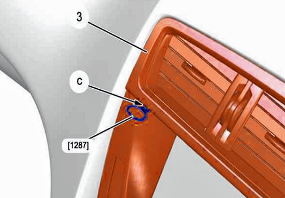

Unclip the multifunction control panel (3) (at "c") using tool [1287].
Detach the multifunction control panel (3).

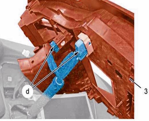

Disconnect the connectors (at "d").
Remove the multifunction control panel (3).
