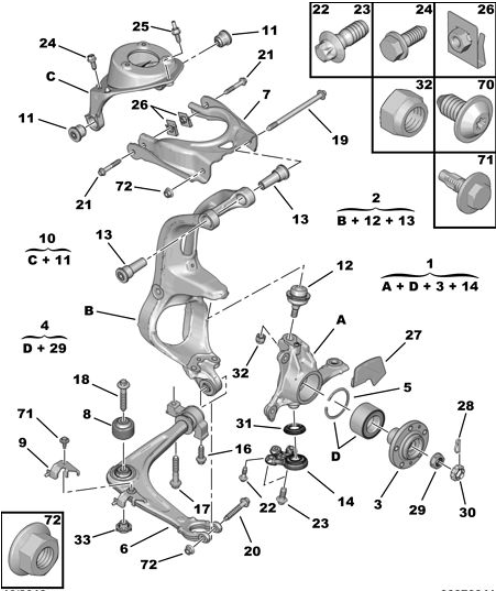

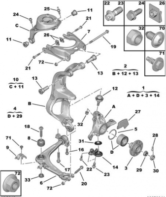

It will be easier for me if you list all the item numbers you want parts for from the diagram to save time Kenny:

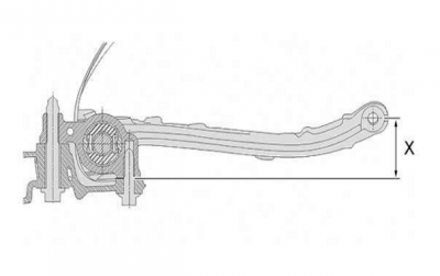

The wishbones are referred to as the 'Front Suspension Lower Arms' for reference and replacement requires removal of left hand driveshaft (for that side), but the right hand driveshaft can be uncoupled by moving the front half axle upwards. The bolts can then be attacked and the front pivot supported.
"X" = 58 ± 5 mm.
Position the front suspension lower arm to the dimension "X".
Tighten:
The (3) bolt
The (2) bolt
The (1) bolt

Re: Front lower wishbone
Item (6)
Left
OEM: 9666244080 £391.10
Cheaper PSA Alternative: 1682731680 £187.43
Right:
OEM: 9666243980 £397.38
Cheaper PSA Alternative: 1682731380 £121.67
I've mentioned the main procedural requirements, but will put something up if I have time this morning.

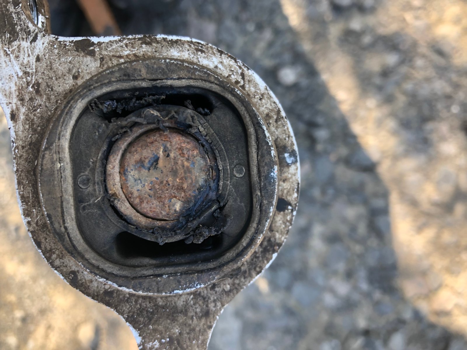

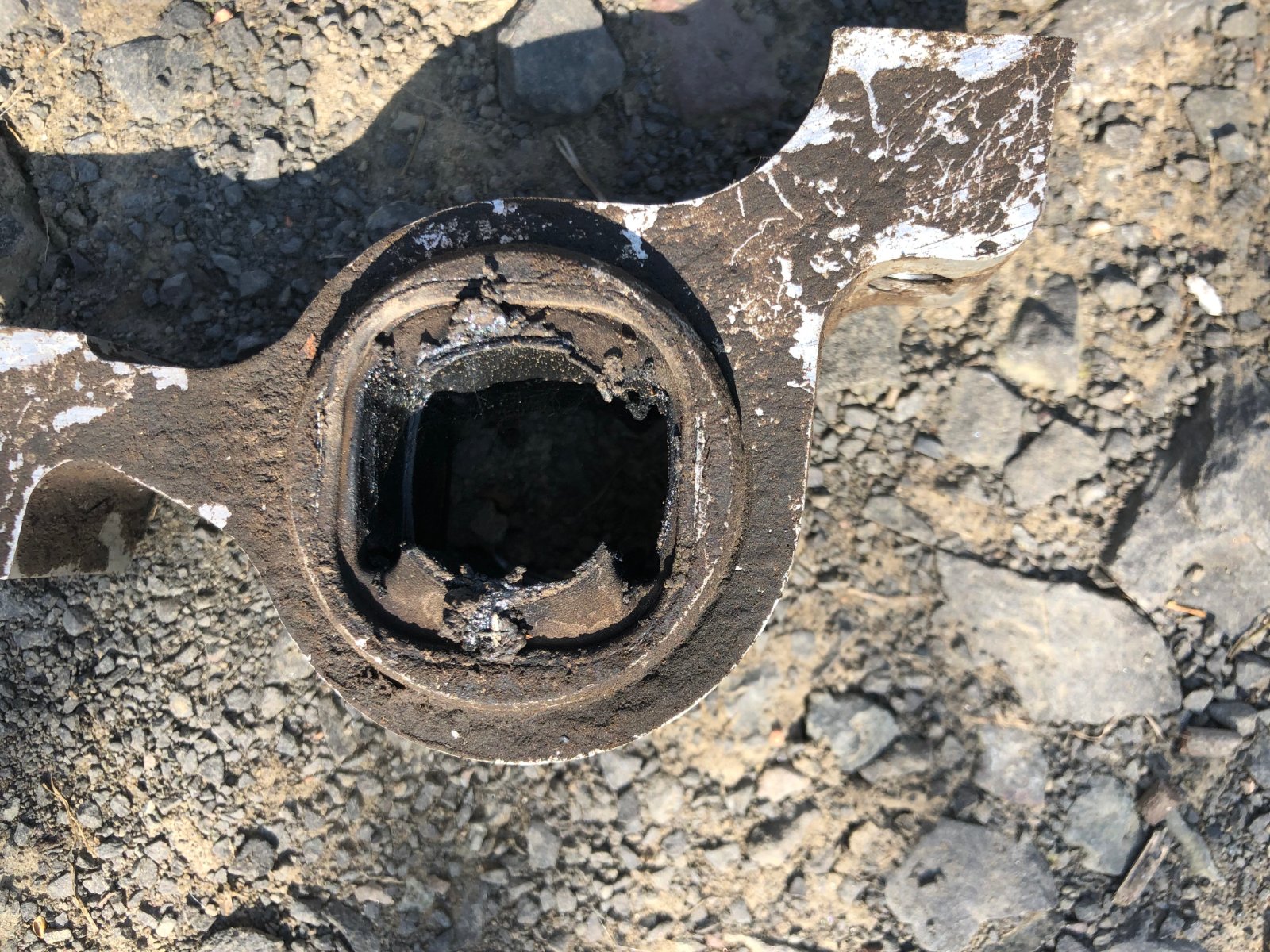

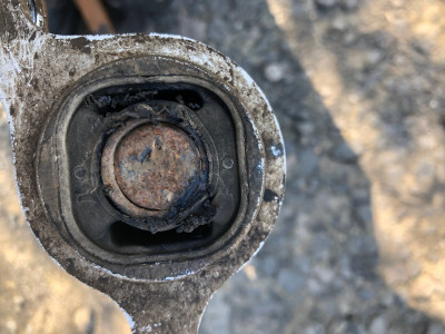

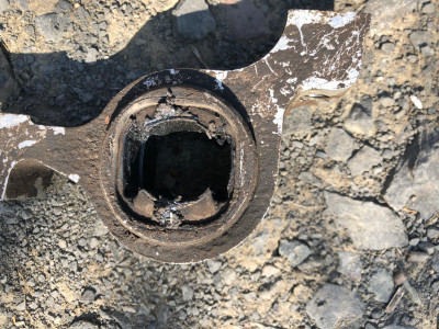

Well sub frame off and suspension arms off.
Offside (right) completely knackered, I was able to pull the front bush off, the rubber was almost detached from the alloy frame, incredible considering these were replace just over 2 years ago (suspension arms).
Nearside is nowhere near as bad but is difinitely on its way out. Will post photo's later
Replacement arms purchased to find I was given an earlier arm with different front bush (P shaped). But this appears to be no fault of the company as it was bagged with the correct part no on it. I suspect this has happened in the factory.
My only concern is what else is worn ? I've checked the best I can but can't see anything obvious.
Thoughts please
Kenny

Borg Beck previous ones and QH the latest ones.
Here are the photo's
TOP photo nearside bottom offside.
My ride height is too high but the car compensates when driving.
I will need to lower it tomorrow.
What is the part no for the front antiroll bar lever ? I have found the following number 5273N3.
Kenny
