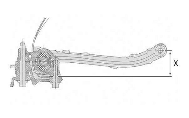

Clunking on braking and heavy acceleration or going over speed humps - but very hard to replicate unless on a lift and using a crowbar to simulate...
It will be easier for me if you list all the item numbers you want parts for from the diagram to save time Kenny:
The wishbones are referred to as the 'Front Suspension Lower Arms' for reference and replacement requires removal of left hand driveshaft (for that side), but the right hand driveshaft can be uncoupled by moving the front half axle upwards. The bolts can then be attacked and the front pivot supported.
"X" = 58 ± 5 mm.
Position the front suspension lower arm to the dimension "X".
Tighten:
The (3) bolt
The (2) bolt
The (1) bolt
viewtopic.php?p=592172#p592172

Ok, so I have just spent a few hours putting together the driveshaft supplementary guide along with the Wishbone procedure, the latter linked to in the guide here:
C5 X7 Removing - Refitting Wishbones (Front Suspension Lower Arm)
