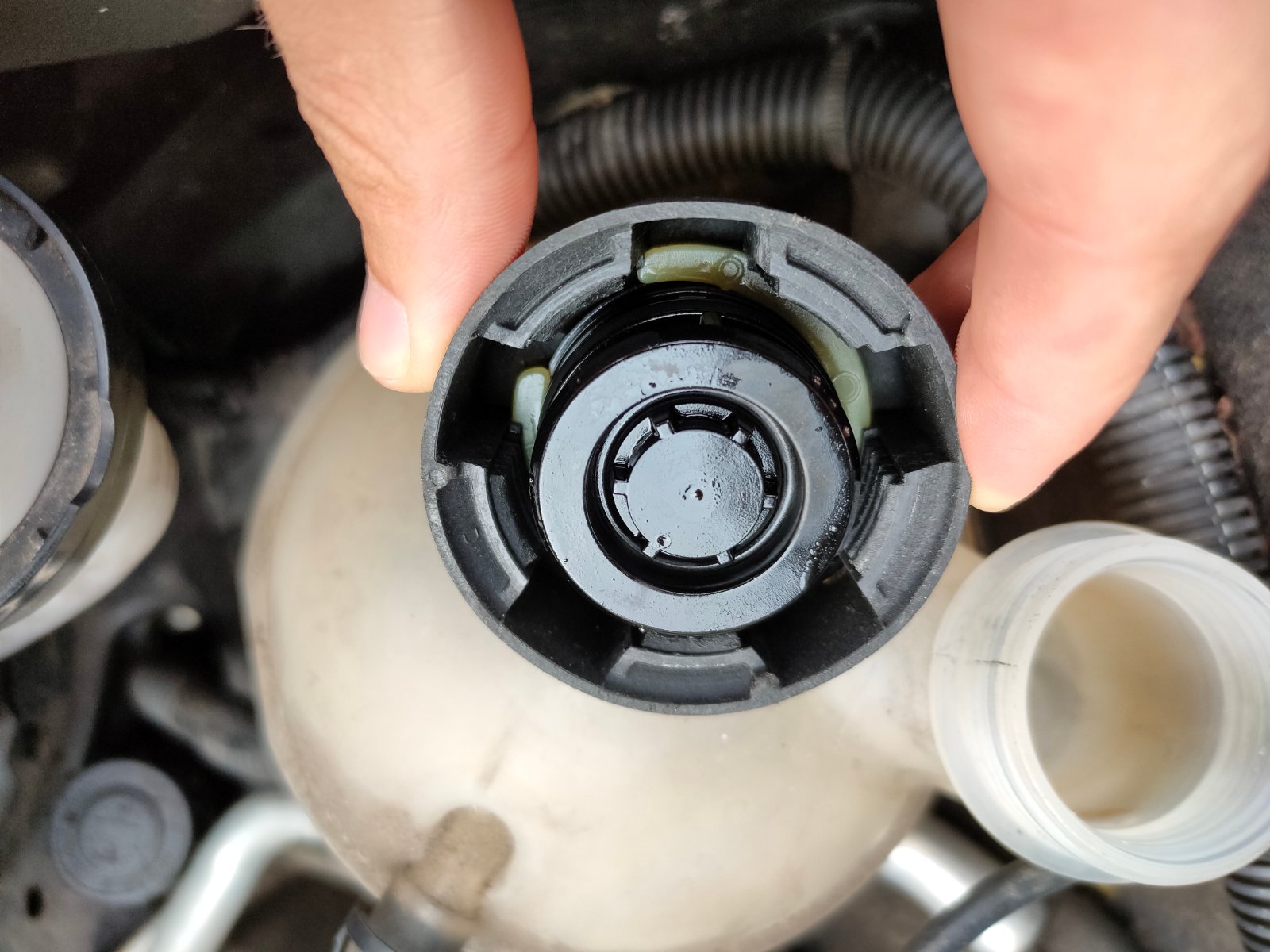

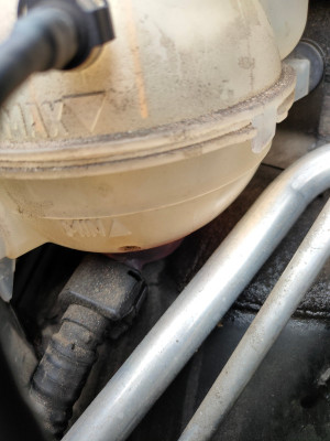

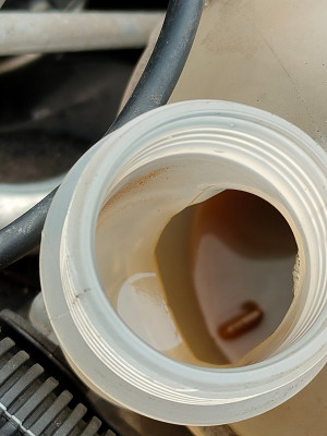

Hi everyone,
After recently purchasing a car cheaply, I've got some issues to get repaired, one of them is to fully flush the coolant system and replace it with a new coolant.
At the moment the coolant looks brown in colour, but nothing to suggest that it is because of a leaking head gasket as it doesn't look like a cream, but correct me if I'm wrong :)
I've never done a coolant flush, but I hope I'm ready to tackle it, using this video perhaps, as a sort of a benchmark on how to fully flush the system .
Bought a Haynes manual, but it's not great TBH for Citroen C4 as it had no specific info on where are the bleeding points. I would guess those would be the lower hose on the radiator, one on the engine block (if there is one on this car) and heater matrix?
Will I need any special tools like a coolant flush kit or anything to tackle this job?
As for the coolant itself, I don't know what to choose, but it would seem that Comma G30 is a replacement to the old G33 coolant that is no longer in production or I can go with something generic like this? https://www.eurocarparts.com/p/triple-q ... OEQAvD_BwE
Thanks :)
