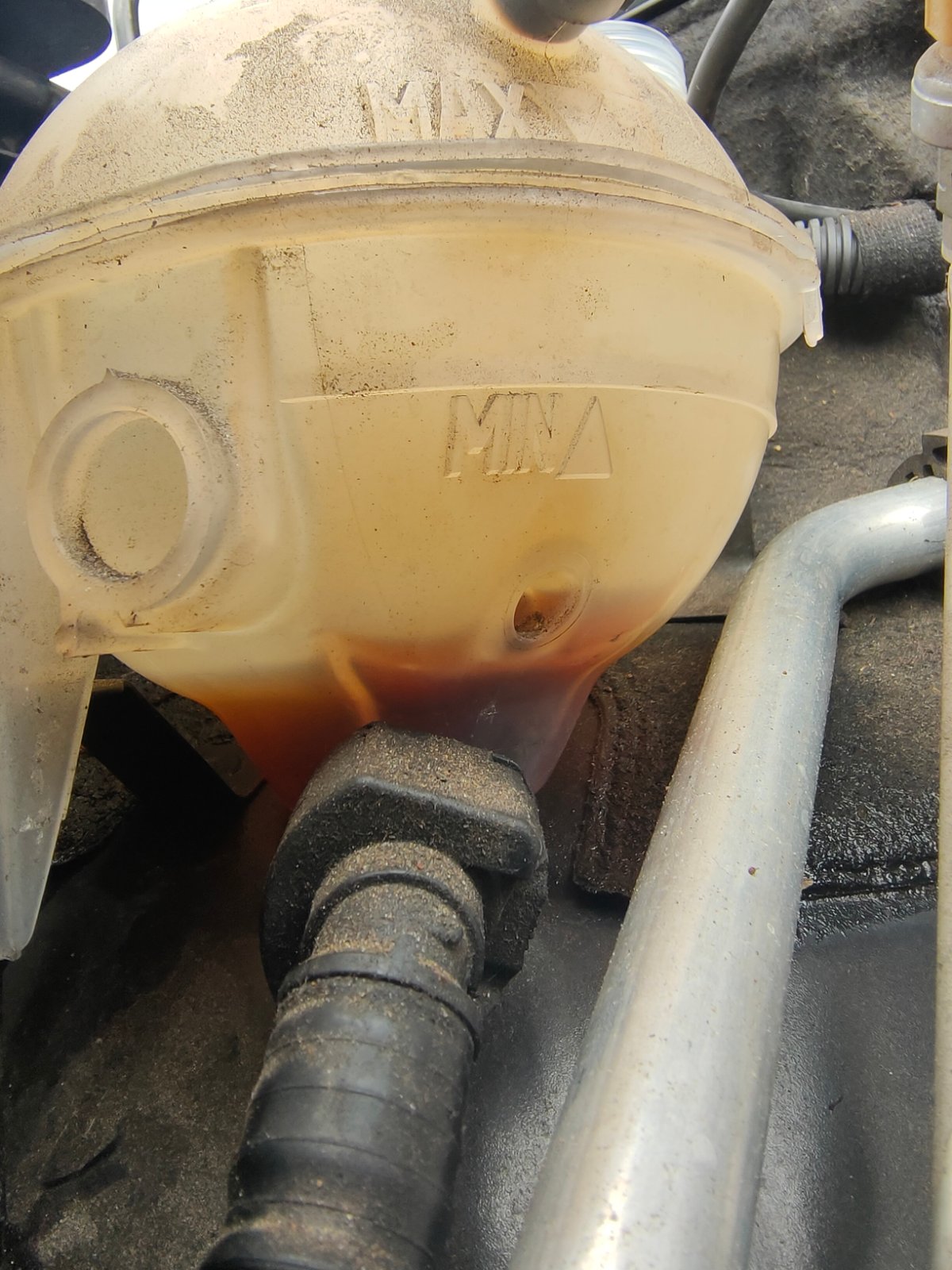

Hi everyone,
After recently purchasing a car cheaply, I've got some issues to get repaired, one of them is to fully flush the coolant system and replace it with a new coolant.
At the moment the coolant looks brown in colour, but nothing to suggest that it is because of a leaking head gasket as it doesn't look like a cream, but correct me if I'm wrong
