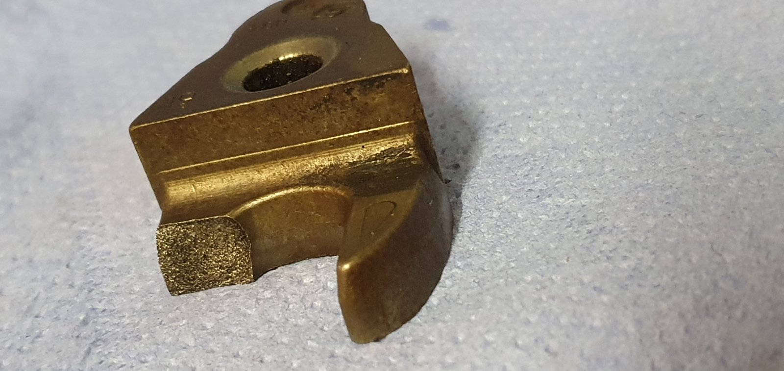

hey guys, I had injector 4 leaking for while now, after good clean of the shaft and seat and placing new copper washer, i set about cleaning the Injector and clamp to my surprise I didn't noticed it before the clamp feet is is broken, could possible help me source the part number or a link to the part please.

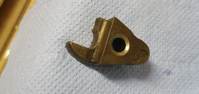

also the Injector no 3 as a different clamp compared to the rest the 3 injector but there's no leaks from comming from that Injector, do I need to change that?

I rang citroen dealership, manged to source the part, ready for collection tomorrow, just wanted to ask do I need to replace the bolt too?
p.s it coms with a new bolt.

The official recommendation when replacing an actual injector is to always replace: The sealing washers, the bolts, the diesel injector flanges, the thrust buttons, and the high pressure fuel pipes. :shock:
