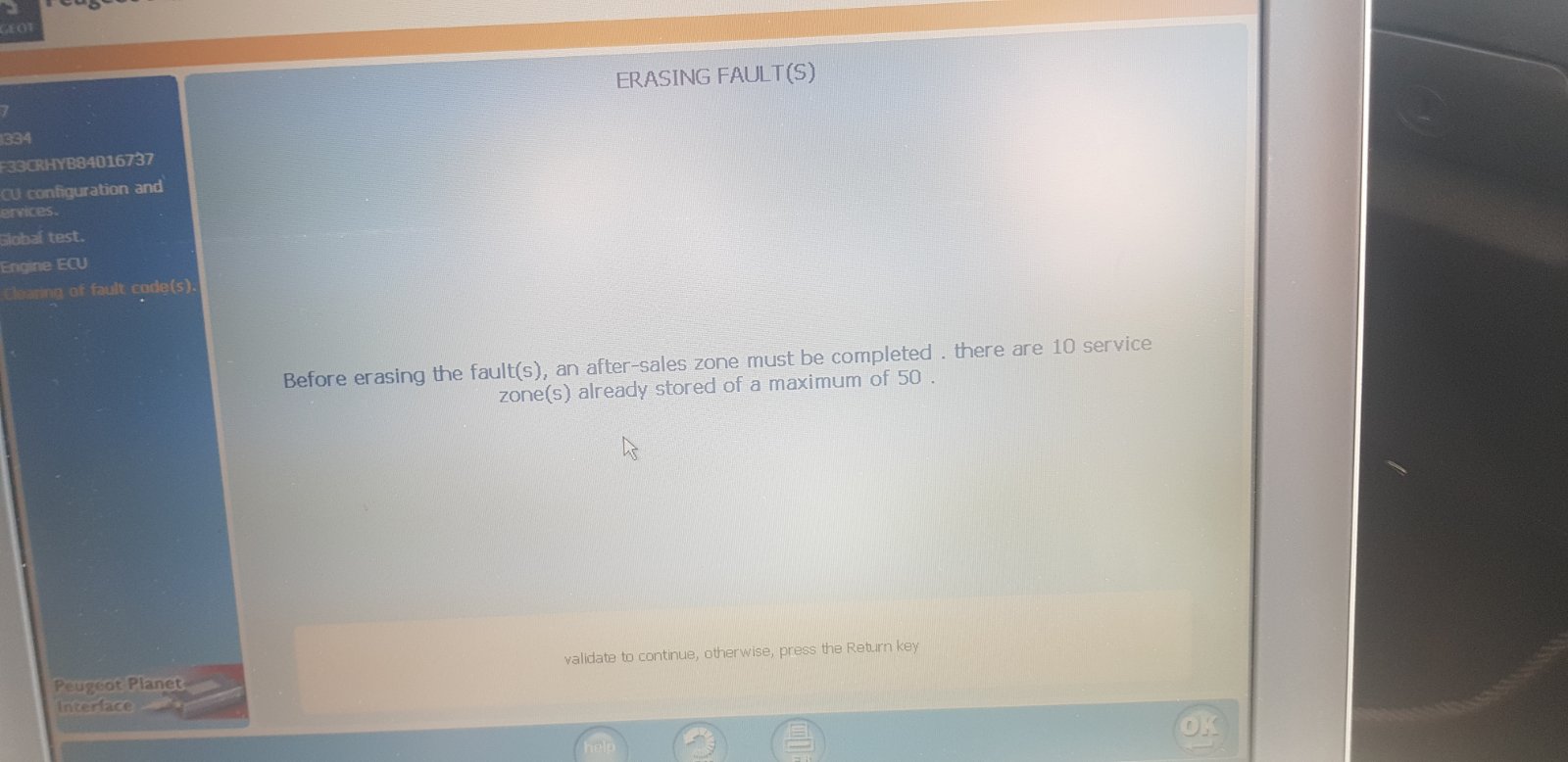

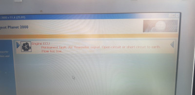

List of current faults, there are 3 at the moment and i'm hoping i've noted down the fault and the code's in the correct sequence.
1,
Engine ECU, Permanent fault. Air flowmeter signal. Air flow too low coherence
- engine fault code P0100,
engine speed 1542,
air flow setting576mg/impulse,
air temperature 24deg C,
intake air flow 282mg/impulse,
turbo pressure 988mbars
2,
Engine ECU, intermittent fault, Fuel low pressure pump supply. Open circuit or short circuit to earth
ECU fault code P0230
engine speed 0
coolant temperature 18 deg C
battery voltage 6.9 volt (s)
Opening cyclic ratio electric cut out 0%
cruise control - cruise control off
Power latch - power latch not active
air conditioning compressor cut off - air conditioning cut-off inactive
EGR valve - EGR not active
3,
Engine ECU, intermittent fault, EGR air circuit fault. Airflow measure less than recommended
ECU fault code P0401
Engine speed - 1446 rpm
air flow setting 465mg/impulse
EGR solenoid valve OCR - 0%
intake air flow 329mg/impulse
actual delivery 24 mm3/stroke
1,
engine speed 1542,
2,
engine speed 0
3,

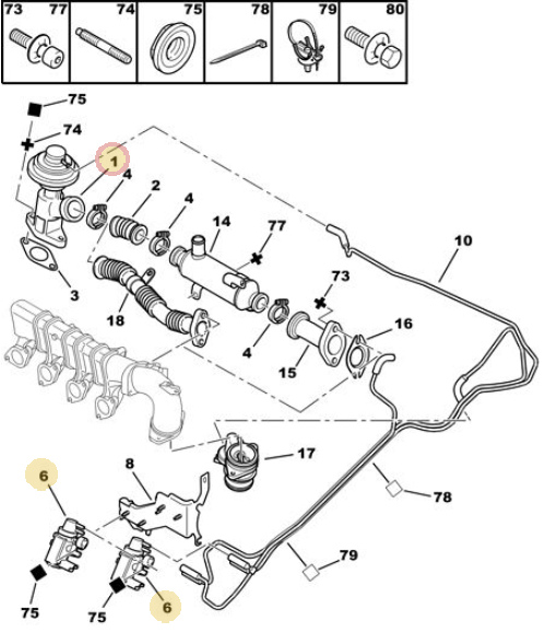

Here you go:
The EGR valve item (1) is part: 1628JZ, and priced @ £335.94
The Electrovalves item (6) are part: 1628ZT and priced @ £102.65 each
All VAT inclusive and from Peugeot direct, prices as of today.

Thanks for that @GiveMeABreak but could possibly confirm that is definitely the correct engine pictured as my car does not have item 17, are the components pictured off a 110hp engine? (Mine is the 90hp engine). I've spent a while online looking at various RHY engines & there does appear to be different versions of the 90hp engine....which is confusing. Item(s) number 6 is mounted at the front of the engine & mine definitely only has one & there's no sign of additional pipelines or wiring indicating that one may have been removed in the past.

I found out item number 17 is an air doser and is apparently only fitted on cars upto OPR 09884 & item number 14, an "exhaust gas water exchanger" is fitted upto OPR 09883 and it's a similar situation with the 2 electrovalves (pictured), whilst the part numbers are the same cars from OPR 09702 only have one electrovalve, the RP number on my car is a higher number meaning it's a *later spec engine in an early shape body (*i guess) which is why a number of items in that diagram are not on my car.
I still haven't really gotten anywhere with diagnosing the fault as it's not often used due to this problem (and a now replaced worn nsf wheel bearing) + it has a dead battery which won't help with the sensitive electrics but i have run the car without the MAF connected now and it goes so much better! I could buy a new MAF but i've read too many stories saying a new one works for 15-20 miles and then fails & having put 3 second hand ones on which made little (if not worsened) difference im reluctant to splash out on a new one.
I have managed to buy a new/old stock EGR valve but i've not yet fitted it, unfortunately there is more than one version too, 1628jz is what i bought but theres also 1628vt too, besides as it's a purely mechanical item im not sure it'd put the EML/anti pollution warning on. I might have a go at checking the power/earth to the MAF but i don't thisnk i can check it's performance output as that might be a job for an oscilloscope

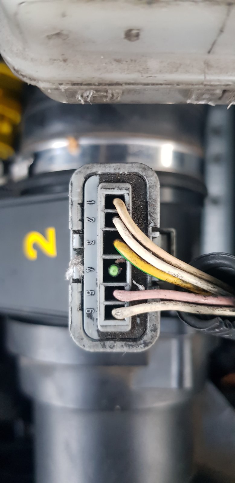

Does anyone know if Peugeot wiring diagrams are available? I read on here somewhere that citroen ones are (at request inc donation etc) but Peugeot ones weren't, at least weren't at the time the thread was created. I have found one diagram but it shows x2 electrovalves but my 90hp car only has one so thats wrong & it was extremely basic anyway.
If i can I'm going to test the wiring with a multimeter but i also don't know what the voltage readings should be, anyone know? I'm guessing there will be x2 12v feeds, x1 earth but i don't know what the signal & other wire should read, particularly at different rpm's .
If the diagrams are available i will post up the rp number & vin but please bear in mind the diagram should only show one electrovalve & not two as per the previous diagram.

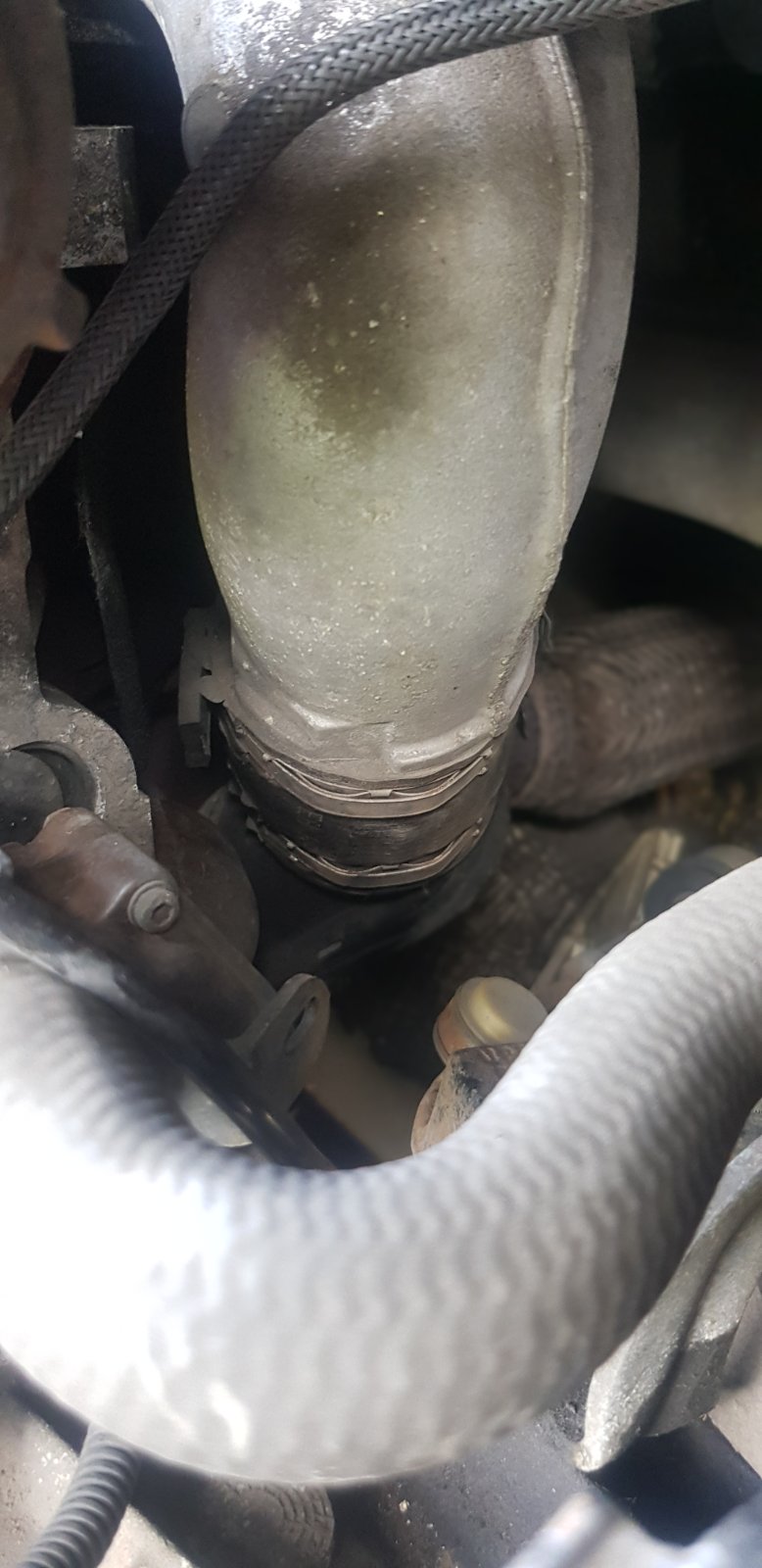

I intend to look into the running fault with this engine again soon as it has on occasion blown out white smoke on start up a couple of times recently, it's definitely unburnt fuel & smells quite strong of it although it goes away after a short period (runs lumpy on start up when it does this). I don't know if this is cooler weather related or not & may have nothing to do with the sluggish/kangaroo'ing problems the car has always had but i intend to do a couple of tests but i don't have access to what the results should be, does anyone happen to know what the resistance should be on the injectors on this engine? I intend to purchase a leakoff test kit but does anyone know what mg's are ok/not ok on this 90hp engine? i'm guessing if all 4 reservoir bottles are (virtually) empty after 1 min of running it will indicate the injector return is ok. I may also buy a noides kit but i've never used them & not sure what to make of any results.

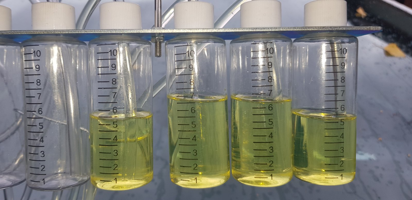

I carried out a leakoff test on this car & whilst such a test is by no means conclusive (whatever the result is) it indicates whatever the running fault & recently developed rough starting may not be a fault of the injectors, however in reality the only way to assess their true condition is to have them professionally tested. What i used was a budget leakoff kit which can be bought for around 20-30 pounds off Ebay But in my experience these are poor as the fittings supplied do not fit PSA injectors, at least not on this 90hp 2.0hdi engine, whilst they can be used i found the retaining clips (original off the car & used for the leakoff pipework) do not fit the injector connectors supplied with the kit. I used fitting number 2 as this seemed to work the best. The test was done on a relatively cold engine due to it's rough starting & the test was carried out for around two minutes. I also carried out a resistance check on the injectors (before & after the test) but without knowing what resistance the injectors should have it's a little pointless unless one happened to be very different to the other three. The resistance was 0.6-0.8 max, never going below or above those readings. My next test will most likely be on the wiring to see if there's any distinguishing pulse issues, i may do this with a test probe or i might buy a noids kit if i can source a suitable one. After this it may well go into a dealer to get the engine ecu updated with the latest software but i am left wondering why it's recently started starting lumpy, i can't remember if this happened before or after i changed the fuel filter, one thing i do know is i reused the original seal as the one that came with the genuine fuel filter (costing around 30.00) was badly twisted & just wouldn't fit in place, i should have returned it but didn't, unfortunately the original seal had swollen up a little after I'd taken it out & so that was awkward to refit too, i sprayed the filter housing with brake cleaner after finishing working on the vehicle today & I'll definitely keep an eye out for diesel residue/leaks on the filter housing.
