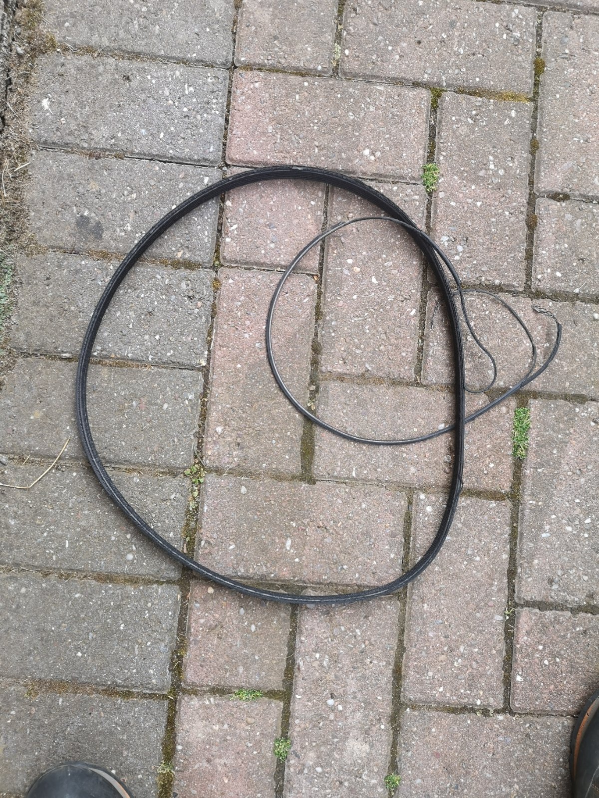

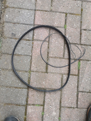

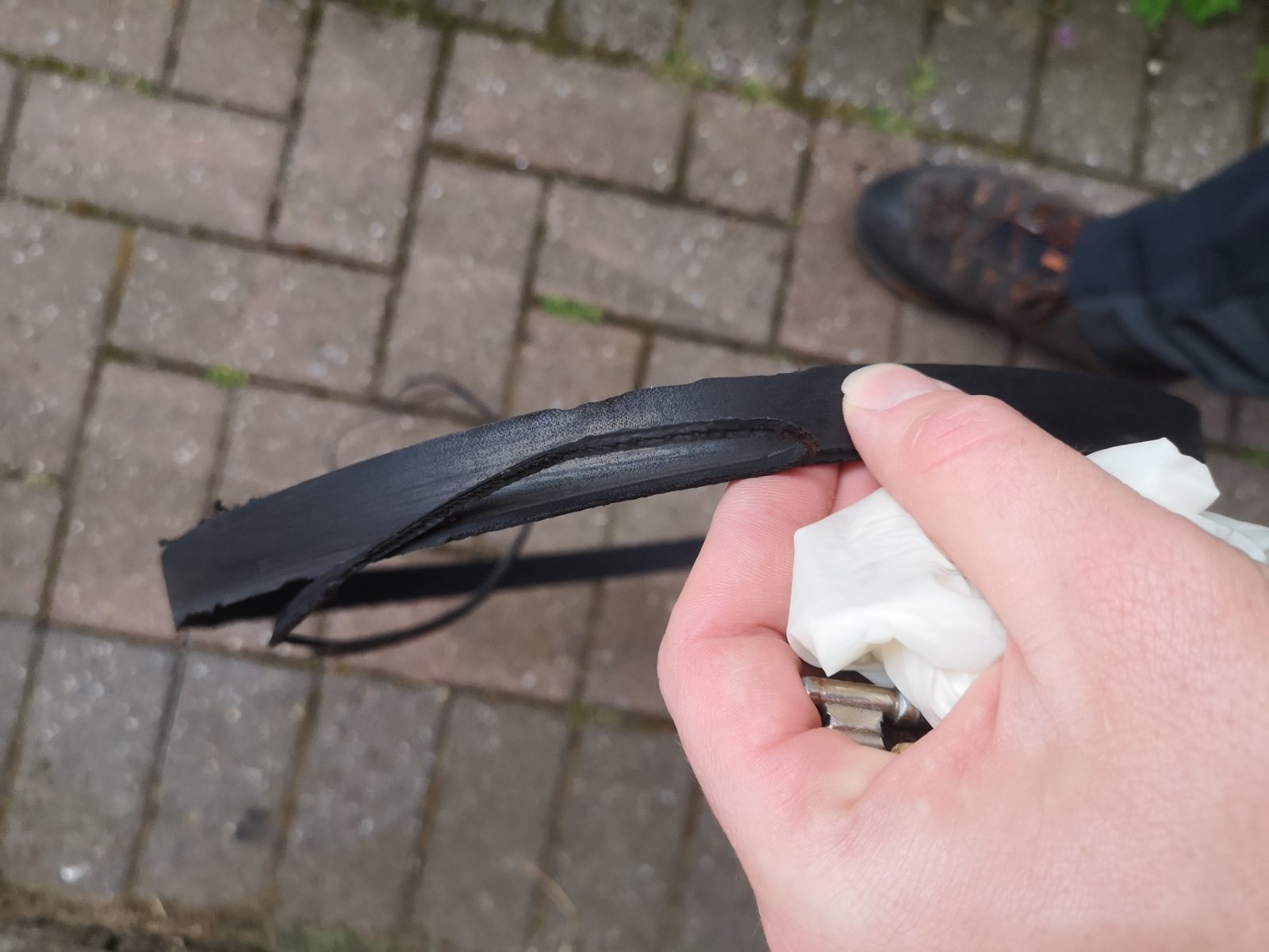

Today I had an error about the electrical supply.. Popped the bonnet and the aux belt had come clean off!
It's pretty damaged too..

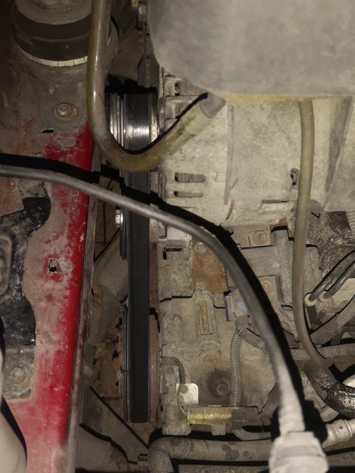

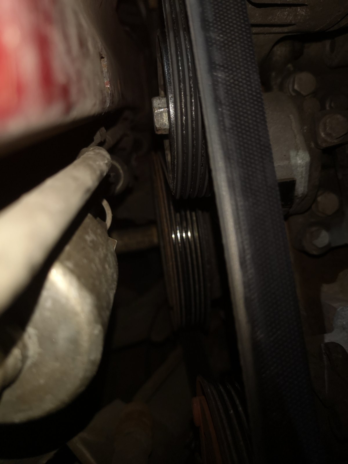

However I noticed something in the alignment. The tensioner seems to be slightly off centre and the belt runs close to the edge at the bottom of the tensioner, but towards the top its way away from the edge.
The dayco belt was one notch wider than the old belt.
I think what happened was the dayco belt ran over the edge of the tensioner, and over time it ripped it apart then ultimately pulled it off altogether.
The attached photos might help to illustrate the general idea.
In which case I should replace the tensioner and see if it all lines up.
Unless there is some sort of way to correct the alignment on the tensioner?
Also, what's the procedure like for replacing the tensioner, is it straightforward?
Thanks!

Re: Aux belt came off..
It's hard to see in the photos..
But the top down view shows the slight misalignment on the tensioner.
And the closeup photo shows how the belt runs close to the side of the tensioner
- x 1751
Agree with you - the pulleys and tensioner do not look properly aligned, and the belt looks at least one peak too narrow.
It you can post your VIN, we should be able to check the correct belt spec.

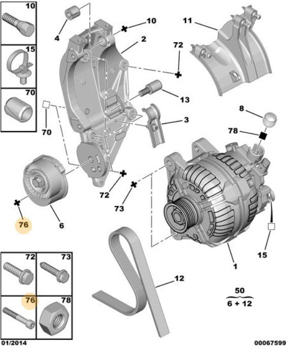

Marc, do you know what the procedure is for replacing the tensioner?
I've looked down and can see one bolt, but not any others. If it's just a few bolts to undo I'll sort it myself rather than take it to the garage
Thanks for the belt info, I'll go to the main dealer.

I cant think of the exact set up on this one but some only have one bolt, some have a second bolt that may only be visible when its fully compressed back.

Ok, so I produced a guide in the resources section for replacing the timing belt for your model (same as mine), which includes the tensioners.Agour wrote: 25 Jun 2021, 15:36 Haha damn, nobody likes them at all!
viewtopic.php?t=62865

Just donated and had a look at that guide, thanks Marc! Just wondering if theres any more steps in the manual for removing the tensioner? Seems like it's just 1 bolt but I want to make sure
wheeler
- Posts: 7927
- Joined: 21 Sep 2002, 19:07
- x 1056
- x 6957
Yes, it's all in the removal guide for the timing belt replacement. Thanks for the Forum donation. Hopefully you'll find some more useful guides in the Resources section:
