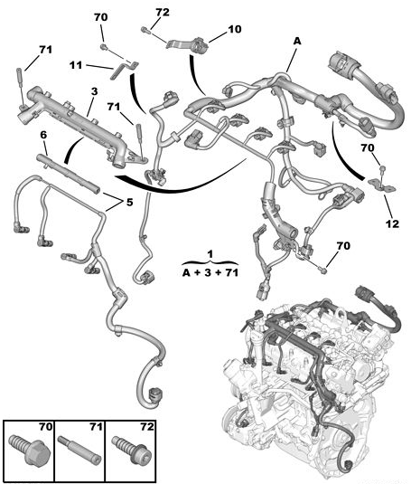

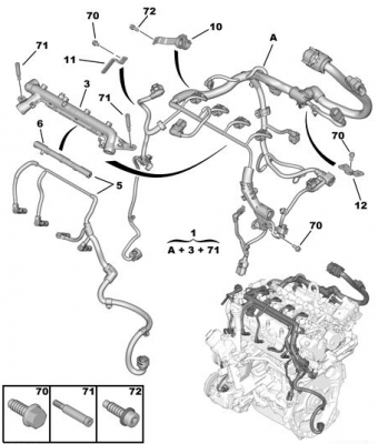

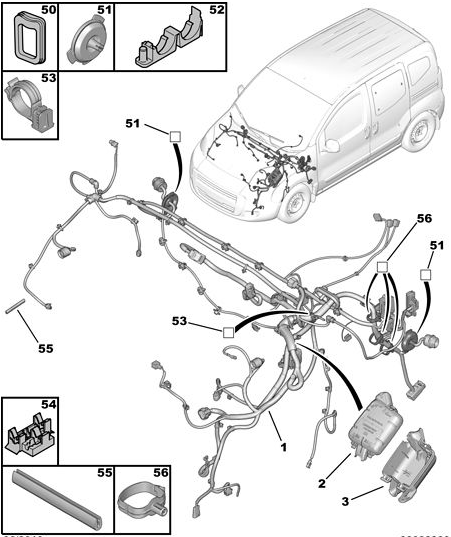

So you'll need to tell me which harness you want as there are are different harnesses depending on what you want:
(A) This is the Main Engine Harness Diagram(B) This Diagram Shows the Under Bonnet Wiring.
The Diagram in Table A is the Injector Harness (1).
The Diagram in Table B is the Main Harness (1) excluding the Injector Harness above.
Let me know which one you need.

Thanks Marc, it’s the injector harness I need !
x 6955
Re: Citroen nemo 1.3 s/s
Ok, so the original part number for the injection harness was 6585N9 but this was replaced with an updated harness, part: 6585R0. The 6585N9 part is therefore no longer available from Citroen.
6585R0 is £890.82 from Citroen, inc. VAT.
It attempting to locate a seconf hand harness, I would try and stick to the later part to avoid issues.
