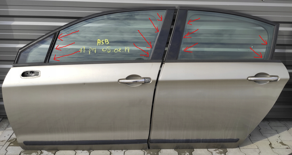

Just spray the channels where you can see them in the top of the door, it will work its way down as you use the windows.
- x 6945
Re: C5 X7 Electric Window
Here, with the windows open of course:
