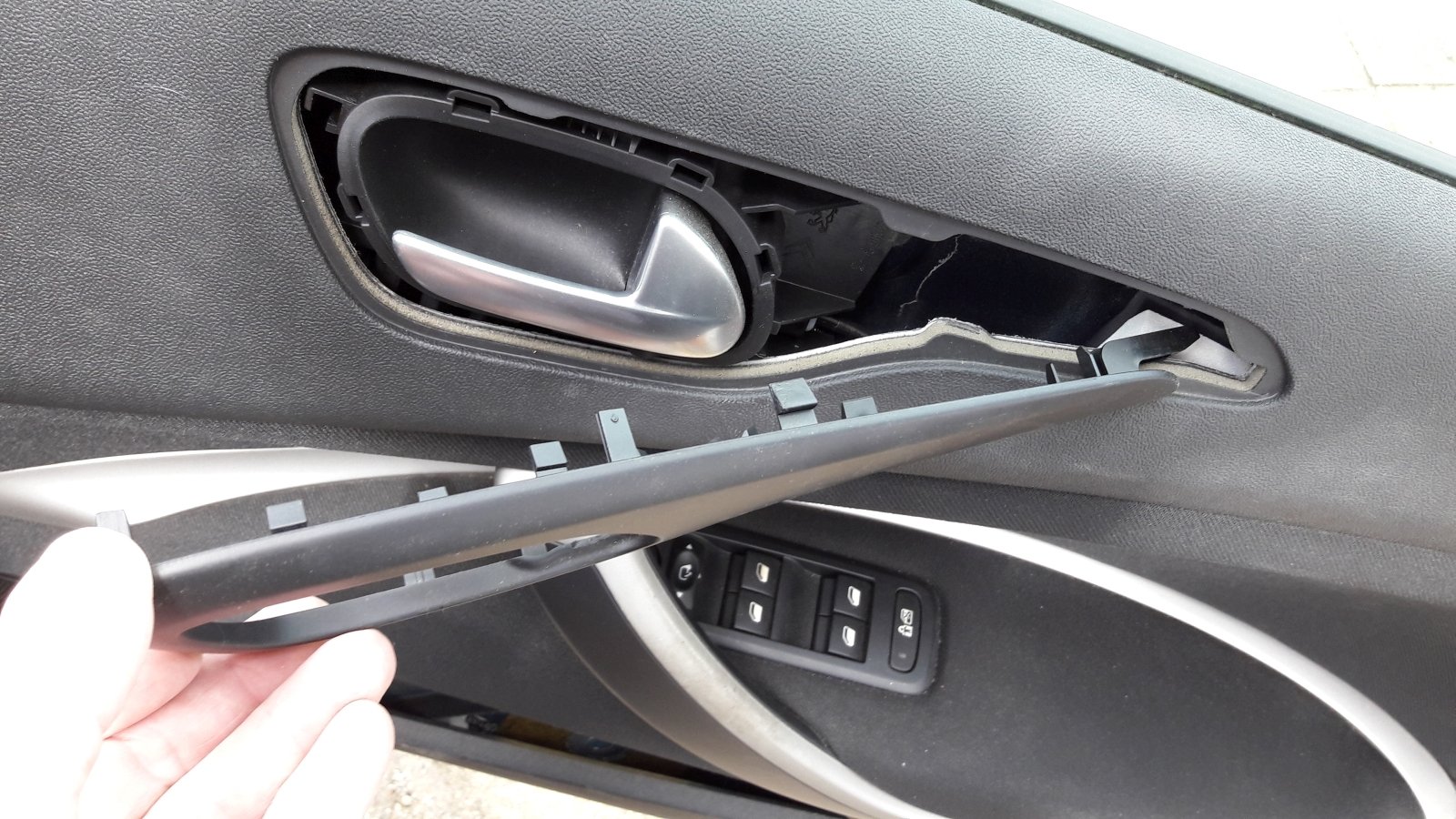

First remove the door handle trim, unclip from the front first
There is a long securing piece to the rear, so the trim has to be slid out forwards

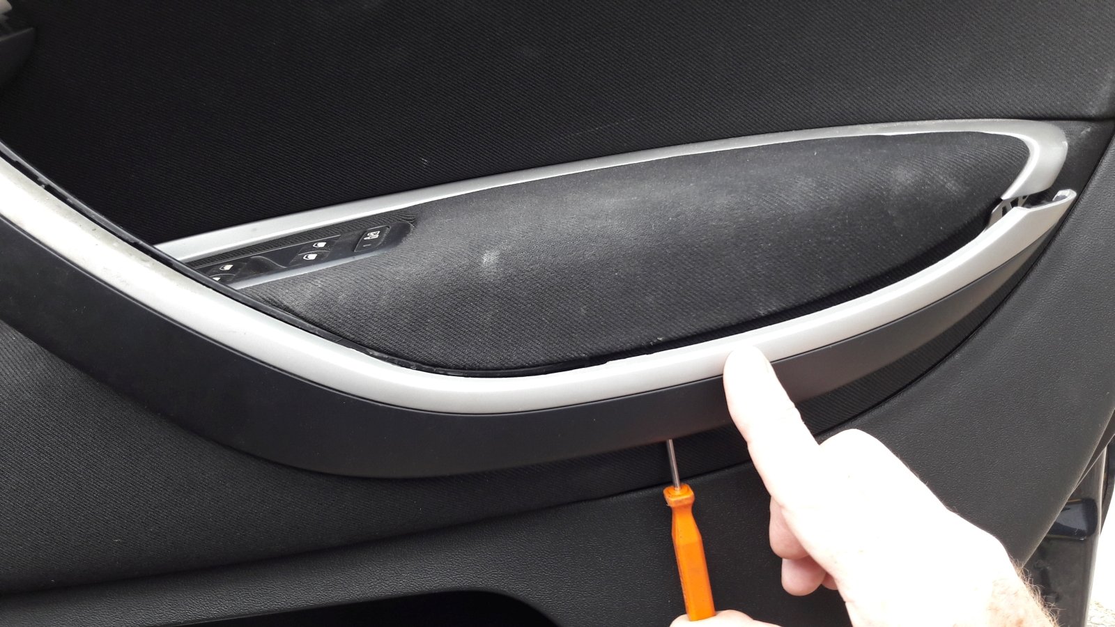

Next, remove the grab handle trim. It is secured with three main clips (circled)
Insert a small screwdriver from underneath to release these clips - starting from the rear
