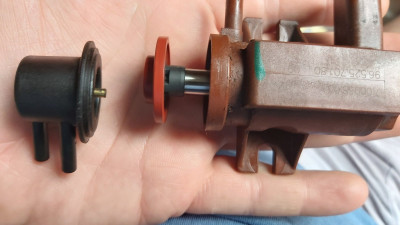

E Slobo. Zar ovde da se na?emo. Da ne kucam ovo ponovo na srpskom. Prevedi na googlu.
When you start the engine, the actuator must pull the variable lever all the way down. As you add the throttle pedal, the actuator loosens the lever and returns it when you take off the throttle.
look at the clip.
Change the sponge filter in the black case number 77 in the picture above. It is located under the hood and above the nozzles.
If that sponge breaks, you will have to replace the vacuum valve or clean it like I did.
If you need a procedure, say so. I will be happy to send it to you.
The problem is that dirt entered the vacuum valve and blocked a small ring filter in the valve itself. I'm sending you a picture.
