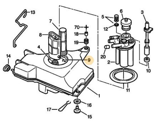

Hi
Would anyone be able to tell me the part number of the little clip which holds the LHM filters in place on a 1997 XM. Mine seems to be missing. Wondering how critical it is to have one, and if they are still available

If you talking about the little S shaped clip (number 9) the part number is 527107 but is showing as no longer available from Citroen.

Out of interest what is part 4

Part 4 is the Hydraulic Reservoir Block Plug - also not available from Citroen.wesacosa wrote: 16 May 2021, 15:44 thanks. yes that was the part I was thinking of. hmm. that's not good its not available anymore

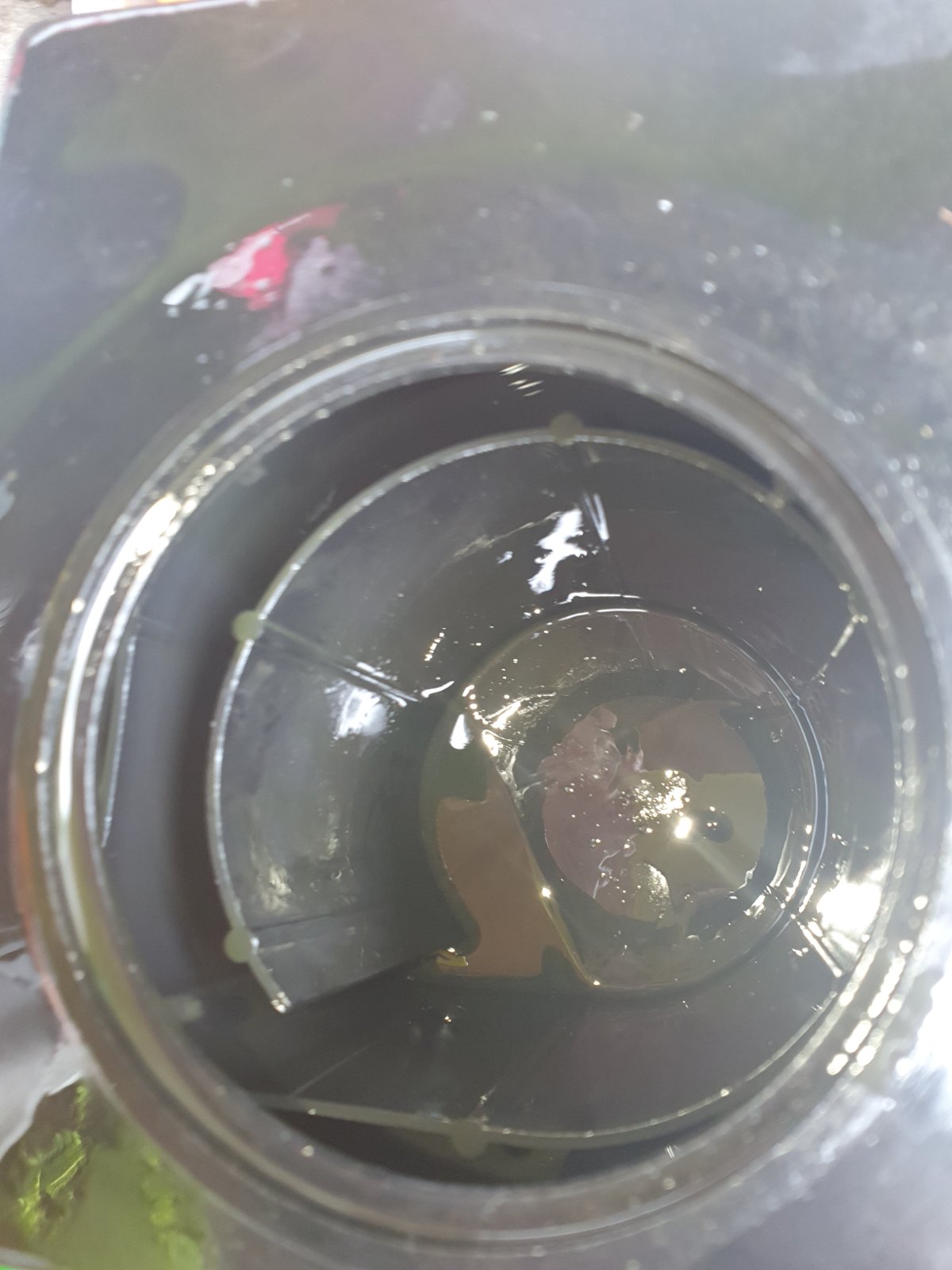

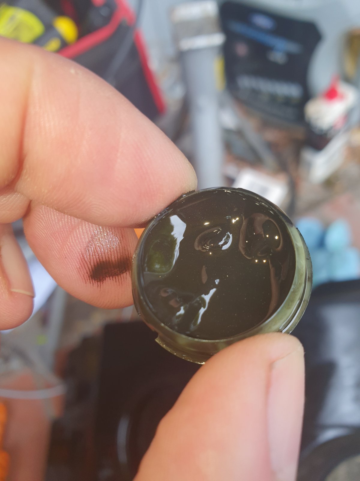

Hmm I don't think I see where part four would even go. I didn't see the clip in the tank but I did see a little disc

If you google "LHM reservoir filters" > images. lots of pics there of the innards.
(The older circular steel reservoir (BX etc) has exactly the same central gubbins.)
One of the pix there throws up this link to a post here:
viewtopic.php?p=365057#p365057
Click on the link in that post, to see a photo of CLIP #9.

Cheers. I had a good look in the tank and so far as I can see its not there, although its a bit difficult to see due to that baffling in the tank. I assume that doesn't come out. I guess if I swill some petrol around inside it might get it if its stuck in some gunk behind those baffles
