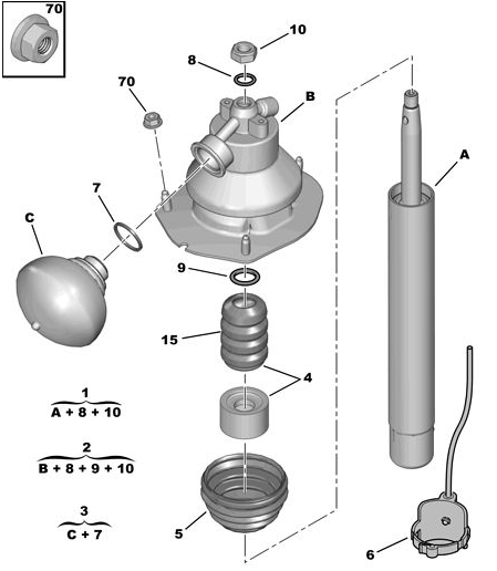

So is the difference between Hydractive 3+ cars and Hydractive cars in the strut head “B” in the previous figure? Is “strut head” the correct name?
The head is rusty on one side so it seems like a good time to change it. Sod’s law has the leak on one side and the rusty head on the other.

The rear struts are different depending on H3 or H3 plus, but it is the Sphere pressures that are also different and the addition of centre spheres for H3 plus models.
So the round saucers are referred to as suspension spheres. Although a Lexia is preferred to fully depressurise the system, the front and rear axles can be depressurised manually.
