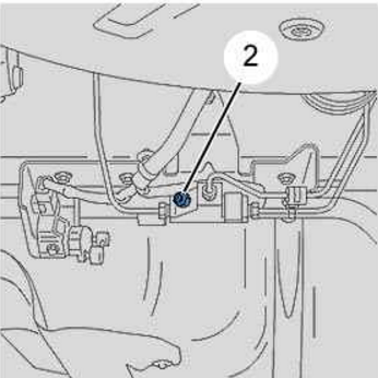

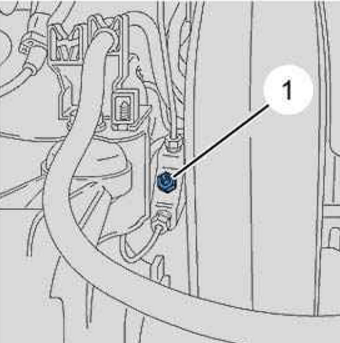

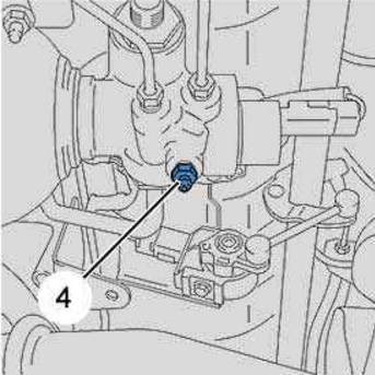

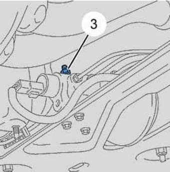

Anyway, Here are the diagrams for both MK I systems (Hydractive 3 & Hydractive 3+) for completeness - concerning the manual de-pressurisation:
Without Using Lexia / Diagbox:
  • Start the engine.
  • Set the height control to the "LOW" position.
  • Stop the engine.
Front (Hydractive 3)
Undo the detensioning screw (1) by one turn.
Wait for the pressure in the hydraulic circuit to fall fully.
Rear (Hydractive 3)
Rear suspension : Undo the detensioning screw (2) by one turn.
Front (Hydractive 3+)
Front suspension : Undo the detensioning screw (3) by one turn.
Rear (Hydractive 3+)
Rear suspension : Undo the detensioning screw (4) by one turn.

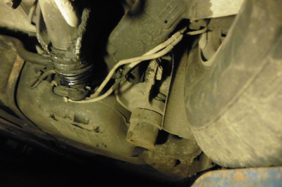

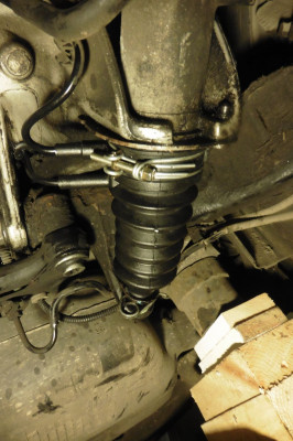

I had to jack the car up then jack the wheels via the trailing arms and slide the ramps underneath, it had lost pressure in the rear and was too low to drive on to the ramps.
The pump had decided not to run today so I could not lift it up.
Another picture of the round things which from posts and a good look at them, are I think ok to use as supports when necessary.
Steve attempting to do the job on ramps compresses the rubber boot, how did you manage to pull the piston out like that, that is after pulling the grenade pin of course ?
If not I can support just that side on the round item and also the sill, plus the centre rear jacking point which I have now located thanks to a posting, then let just that wheel drop : )
I also had a go at the two bolts that hold the ram on in case I cannot do it in situ, they would not move so I have left them soaked in WD40.
Gods Bless Spiff

As I said several posts ago, you can't get the push rod out the end of the cylinder (with the cylinder mounted in position on the car) unless the rear wheels are hanging free - it's a physical impossibility, for reasons you now can see.

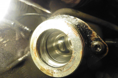

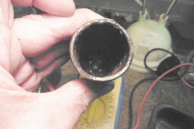

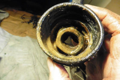

Good evening all from a very wet and windy Mullion Cove Cornwall : )
I found out at the start that both wheels have to be hanging free, as they are connected by I think the anti role bar.
It is therefore not possible to just let one side hang free, and not possible to get the piston out with out the wheels hanging.
I did the job in situ as my sphere removal tool was for a Xantia and will not open far enough for the C5 spheres.
Getting the old seals out was simple enough using two jewellers screw drivers.
Fitting the second one of the two that both go in the same slot is a little tricky.

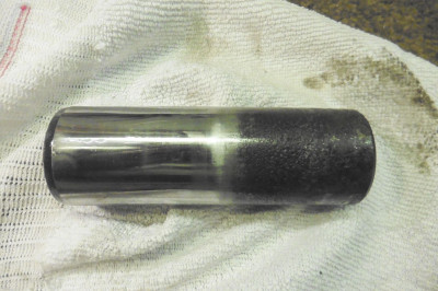

The part of the piston that protrudes into the boot was rusty, but the part that goes into the seals was OK.

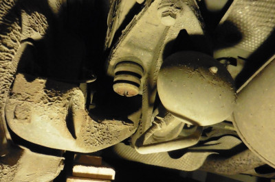

I have not dropped the car yet to try it as the bump stop is missing, it looks to have been gone for years as the dirt covering where it was is uniform.
They are a bit pricy on eBay, so have emailed Eurocarcare.
It will as other members commented be easier the next time : )
I spent a couple of days in making sure the car was safe on blocks and one day doing the job.
Once the bump stop arrives and is fitted we shall see if it all works.
The reason I do not want to try it without the bump stop is that without it the piston can go further in and the rusty part could hit the first seal ?
The pictured bump stop is the other side.
It may have been mentioned already, so apologies if I am repeating, the round item that was being discussed as a jacking point is named on eBay as a REAR SUSPENSION VIBRATION DAMPER WEIGHT 512251
