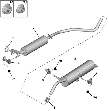

Re: New rear silencer and rear exhaust hanger
Hi Dan - yes, thanks - I've been in the middle of a few technical issues with Diagbox, so give me a few minutes to sort this for you.
- x 6955
Ok, so here is the rear silencer and also the mountings:
You can use this to source an equivalent part.
As of today:
Flexible mounting (6) is part 1755L3 costs £22.74
Rear silencer (3) is part 1730JS and is £274.69
The Flexible mounting (7) is part 1613713580 and is £18.49
The Exhaust Front Pipe Sleeve (8) is part 173631 and £53.82
All the above are VAT inclusive but don't include fitting.
At least you can search on these parts.
As of today:

Cheers Marc, thanks for that. Seems the parts are quite expensive on their own. I'll take a look aroundGiveMeABreak wrote: 23 Apr 2021, 20:32 Ok, so here is the rear silencer and also the mountings:
As of today:
I suspect it's just the band that goes around the silencer, fits into part 7, that has rusted through. They are notorious for it and, suprise suprise, are not available separately from Citroen. However they are available elsewhere, eg this one, search on ebay for 383498149601
