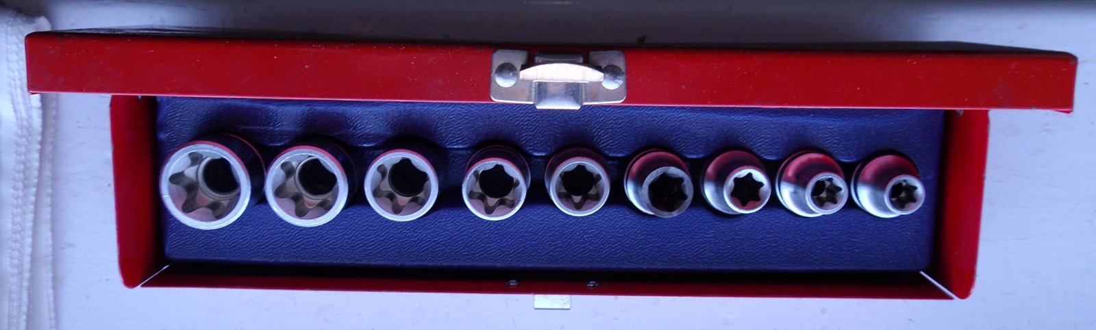

This is my set they're marked E10 to E24

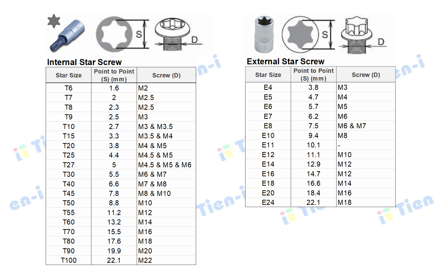

Hi!moizeau wrote: 22 Apr 2021, 16:37 Thanks very much Gibbo, what sizes do they relate to in mm please?
Cheers
Hope it is of some help. I've always found it useful to know the mm sizes of torx heads. The metric screw stem, as Gibbo said, often varies, since one torx head can accommodate different stem diameters. The most usual ones are listed here too.
Bye
Davide

I have a long cylinder head stretch bolt here, I've just checked against your chart, it has an E14 head but the screw is only 9mm so as I said not always as you would expect.
