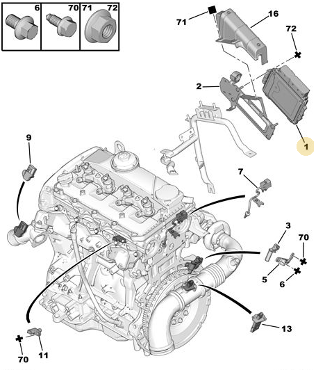

Ok so, for the Injection ECU: Item (1)
Brand New: The original PSA part number was 1943CS, but this was replaced with a newer part: 9666484680, £1603.82
Peugeot also provide an exchange ECU and this is part number: 1677661380, £1603.81

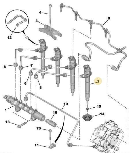

For the Injectors: Item (2)
These are Ford / Denso. New, PSA part number: 1980J7, £552.59
Exchange, part number: 1980T7, £399.61
