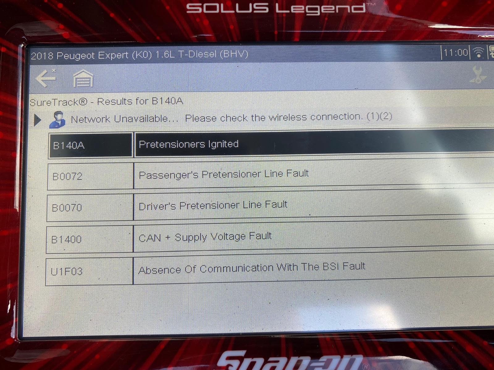

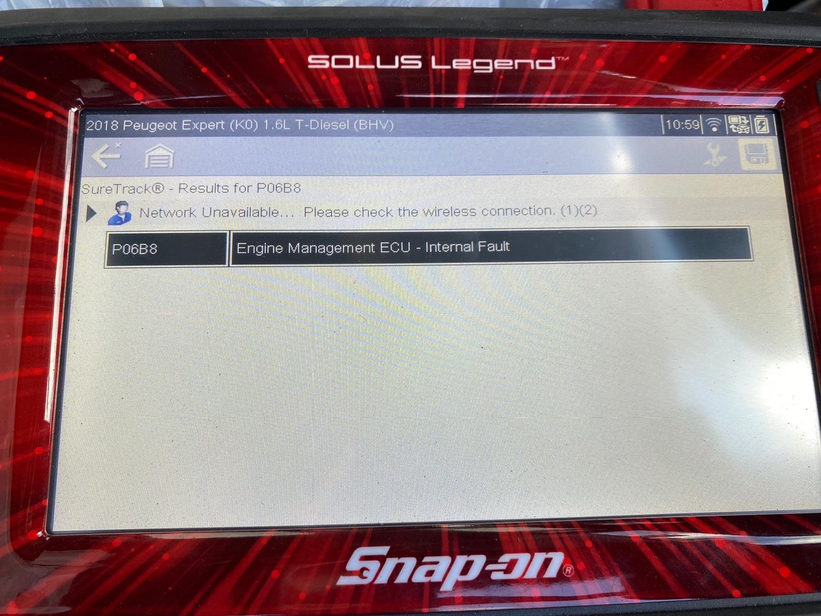

Hey guys, i have some crash data on my Peugeot Expert 2018 and the garage i went to couldn't resolve them, if i buy lexia 3 kit would I be able to get somewhere with Diagbox, ive attached some images of the diagnostic report.

You probably won't get any more explanation wise than what you have above. Diagbox (the software) can undertake live tests and let you see the live data, but won't really tell you much more about the code. Also, for a 2018 model, don't bother with anyone offering Diagbox V7. You'll need a later Version (9.**) to be able to deal with newer ECUs and their software in later vehicles.

Thanks for the reply, would i be able to clear the faults though because it’s been repaired but the faults persist, needs some sort of reset

IIRC crash data can't be cleared with Diagbox, it has to have the unit virginised which is doable but you need a different tool to read/write the flash.
