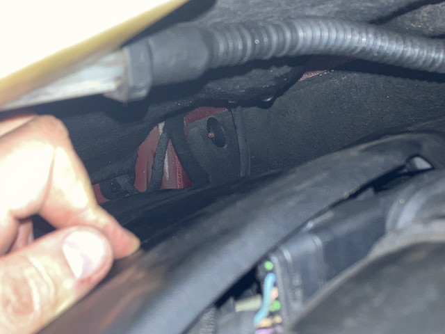

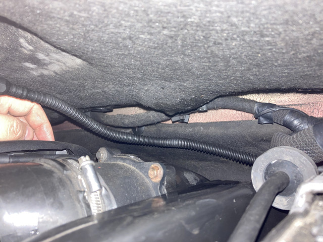

Just had a quick look in the peeing down rain to get my vin number and to see if I could inspect the egr which I just realised is pretty hidden but I’ve noticed with it raining I have water dripping down behind the scuttle panel onto the top of the engine and also very close to where I think the egr is

- x 6955
Re: C4 GP 07 1.6 HDi Handbrake faulty ESP/ASR Warning ?
The VIN will be on the outer, lower corner of the passenger windscreen if you need it quickly.
Re - the water, you may want to check that the scuttle drains are not blocked up with leaves and other crud. These can be unblocked from under the wheel arches where there should be a flap where the water runs out: Video here which is easier than writing an essay!
