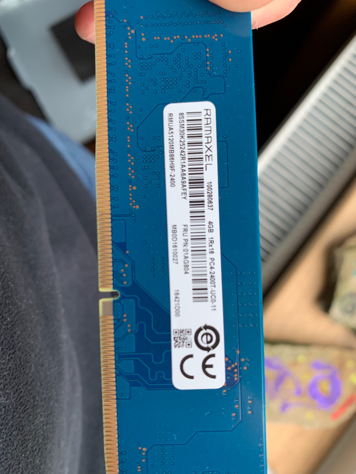

Can any PC techy type people here identify what type of RAM this is? I know theres a few different types. Its from a Windows 10 desktop. Im looking to get another one to double up the RAM to 8gb.
Tried typing some of the numbers into ebay but nothing helpful comes up.

Search for 'Ramaxel PC4 2400T ram' and you will get many options.

It's ddr4 type ram running at 2400 mhz, If you got onto Crucial's website you can ask them to scan your PC to find the correct stick.

Exactly, thats the problemmickthemaverick wrote: 27 Feb 2021, 08:32 Search for 'Ramaxel PC4 2400T ram' and you will get many options.![]()
So its DDR4? Does it have to be 2400 MHz or can you go higher/lower?
Also does RAM have to be in equal pairs or could you have a 4g & a 8g ?
