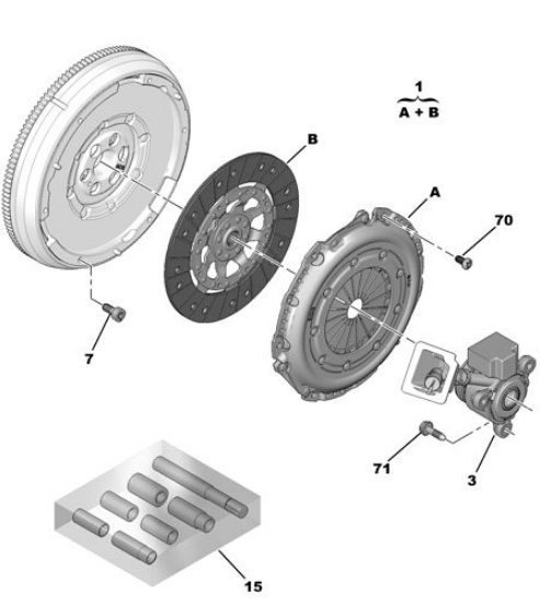

You have 2 options from Peugeot:
OEM Peugeot New Kit: Part 2052X5 £374.69
OEM Service Exchange Kit: Part 2051Y8 £200.00
Similarly for the thrust bearing item (3):
New Peugeot OEM Part 204195 £124.67
Cheaper version offered by Peugeot 1666662980 £123.13
All prices UK VAT inclusive as of today.
Don't forget you'll need a centring tool and adaptor to fit it properly.

- x 6957
Re: Which Clutch Kit to choose for 3008
You didn't ask about the Dual Mass Flywheel which it is recommended you do at the same time as the clutch:
Original New: Part 0532Q4 £773.57
Exchange: 1613938480 £450.90

Recording to the information you provided me LuK 600 0297 00 Clutch Kit is what I need.
LuK 510 0129 10 Central Slave Cylinder, clutch - Is an alternative to New Peugeot OEM Part 204195
LuK 623 3241 09 Clutch Kit - Is an alternative to OEM Peugeot New Kit: Part 2052X5
and the
LuK 415 0396 10 Flywheel - Is an alternative to Original New: Part 0532Q4
The whole set will cost 385 euro! That is 300 cheaper than what my local shops quoted me! I'm aware that there are not "original" parts but hey this car is already 11 years old....
and the

It will be a concentric type thrust bearing, it has the clutch hydraulics integrated to it.myglaren wrote: 15 Feb 2021, 17:50 What happened to thrust bearings? The last one I bought was eight quid!
Genuine PSA clutches used to come with an alignment tool too but now you need to buy it separately.

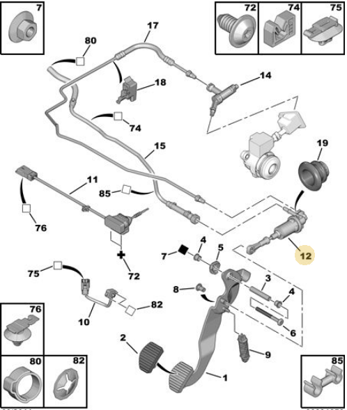

Hi, there could you find out the part number for "Master clutch cylinder" ... That was the reason why the whole clutch went.... someone put it the wrong way... I'm having a hard time to find the spare part for it.
- x 6957
Item (12), Part: 2182F5, £98.06 Inc. VAT
