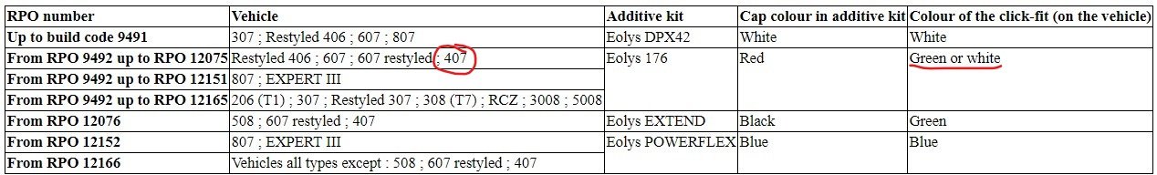

DPX42 was only used up to around late 2002.
On that RP number it should be Eolys 176 fluid which can have a white or green click fit connection.
If it previously had Infineum F7995 additive you can add Eolys 176 no problem without draining first.

I think your info may be out of date as it still refers to Infineum F7995 which has now been made obsolete.
This below is official guidance which also states the colour of the click-fit union on the filler interface is not sufficient to determine the recommended additive.
Only the RPO number of the vehicle can precisely determine the recommended additive.
One of my own vehicles has a build date within a few days of the changeover & has contradicting click fit connection colours to what should be on it.

The Peugeot document I’m using was last updated in January 2021, the Citroen equivalent of the same document also has the same date.
Id say this car is way too late to use DPX42, it was only used on the earliest FAP equipped vehicles up to late 2002.
