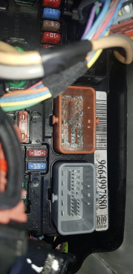

Re: Peugeot 207 under bonnet fuse box
Have a look at mine.. Dont leave it and use a, manual switch get it changed..
Ours started off locking everytime we shut the drivers door.. Then the starter decided not to work then when it did the. Car. Would not fire. Up only spin over..
Matched the layout to another one.. They don't need coding they are. Plug n play.. Fitted it.. Car. Ran purfectly and the locking from drivers door closing also stopped...

- Posts: 55070
- x 8391
That's some nasty corrosion in there Paul
Not surprised it started doing odd things!

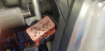

Yea clues where there but I assumed it was door lock or loom between door and A pillar at first like previous citroens..
I've put grease in the socket and plug for now..
