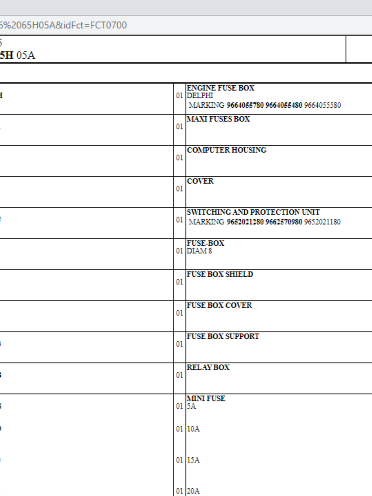

My problem is the ambiguous part numbers listed. See attached.
Mine is 9664055580 which l cant find but also listed for my car are 9664055780 and 9664055480 which l can find.
Can anyone confirm for me that they are interchangeable?

These are really confusing - PSA give them a part number, sometimes starting with 96, but there is another number printed on the fuse box, also often beginning 96, but which is different! If you are looking for a second hand one find one that has the same number printed on it as yours, ignore the PSA part number, unless you want to buy a new one.

I eventually found a used fuse box 9664055580 on eBay as they apparently are no longer made so new wasn't an option. Unfortunately whilst it looked ok on the surface once you started pulling the fuses some had white powder around them showing they where corroded but l fitted it to check and sure enough it was US. I then found a 9664055780 for £15 including post so decided to give it a go as although it wasn't the same number as mine it was listed in the photo on my original post. Success everything ok again.
So it would seem that the numbers 9664055780 and 9664055480 are interchangeable with 9664055580

Yes but the adverts on eBay usually get listed by a single part number from that list and l could not find info that the relays under the fuses actually did the same thing so posted for any one else looking.
The actual surface plugs are identical.
