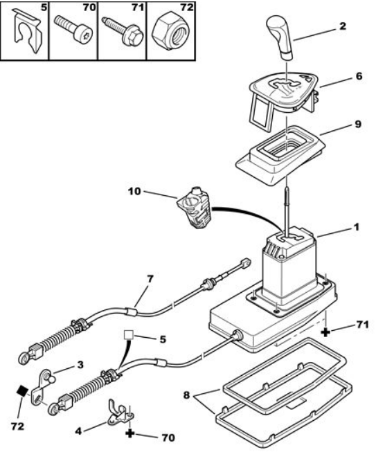

Here you go Mick:

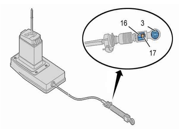

Is this the part you want:

Thanks Marc, It would appear from that diagram that the part I need is number 10 and comes as a complete housing with the detent installed. Any chance of a part number for it or is it discontinued? Cheers
- x 6945
Re: Automatic Gear selector Mechanism
Item (10) is called the Hardness Tester (?)
Part number is 240778 and is £11.41 from Citroen inc. VAT - still showing as available.
