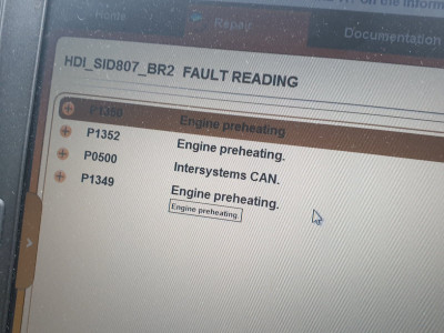

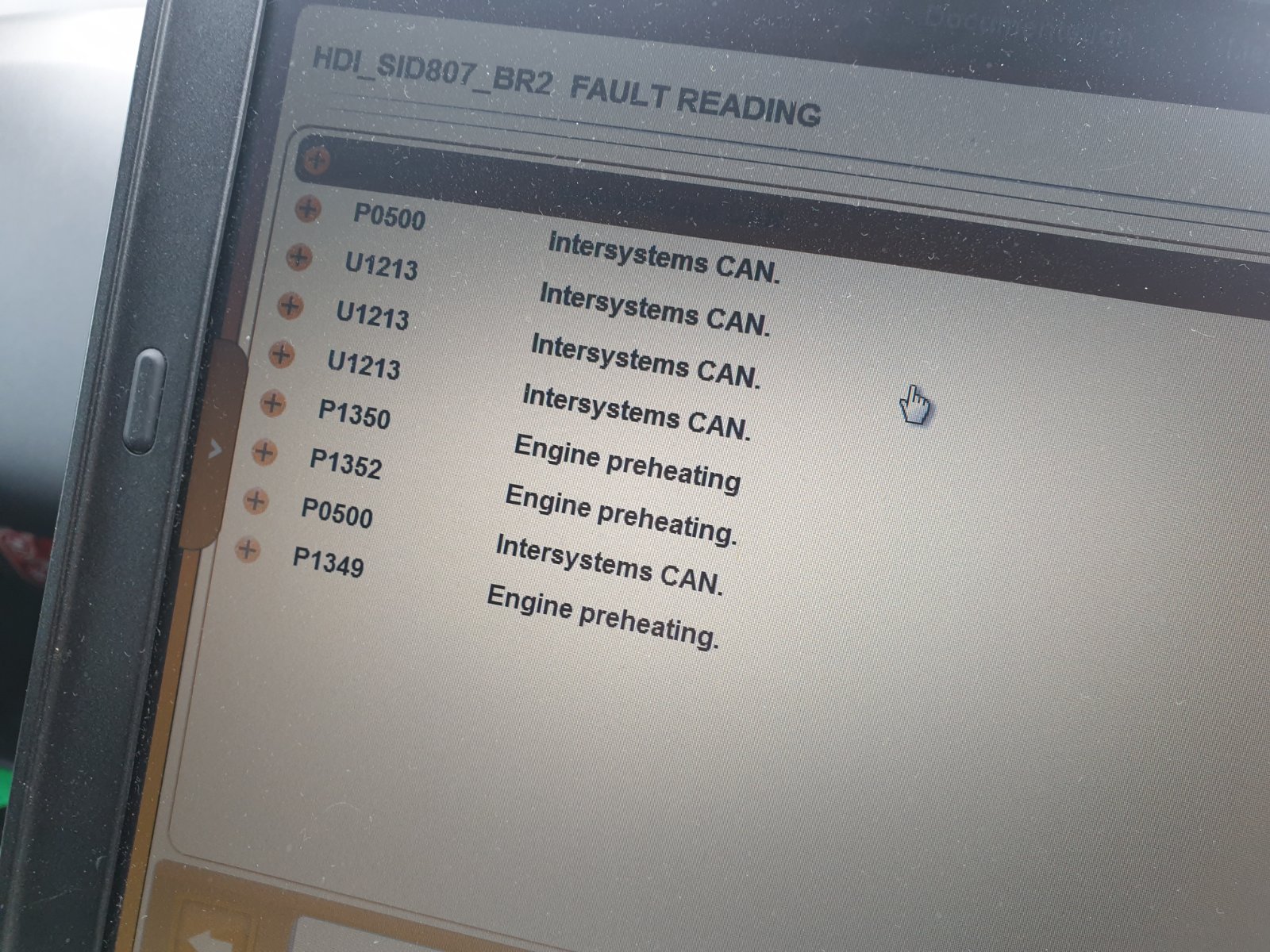

Re: 3008 Diesel. No start. ECU issue.
I have made progress suddenly.
Don't know how!
Don't know how!
Nothing in life is free...
GF1969
- Posts: 43
- Joined: 18 Apr 2020, 15:27
- x 5
That list has now shortened and I now have these

From those initial codes, they mostly seem electrical communication faults on the CAN network which means there is no communication. The pre-heating codes can be ignored asn they relate to the glow plugs and are not really needed to start the car. So you definitely have an electrical problem that needs investigation. But do confirm you have an AGM battery and of the correct capacity, as these are designed to be able to cope with the frequent starting cycles of a Stop Start system.
Then next thing I would do is test the battery and ensure it is being charged properly. You also have a reversible alternator on this vehicle and a separate starter system. So I would also get the alternator checked too.

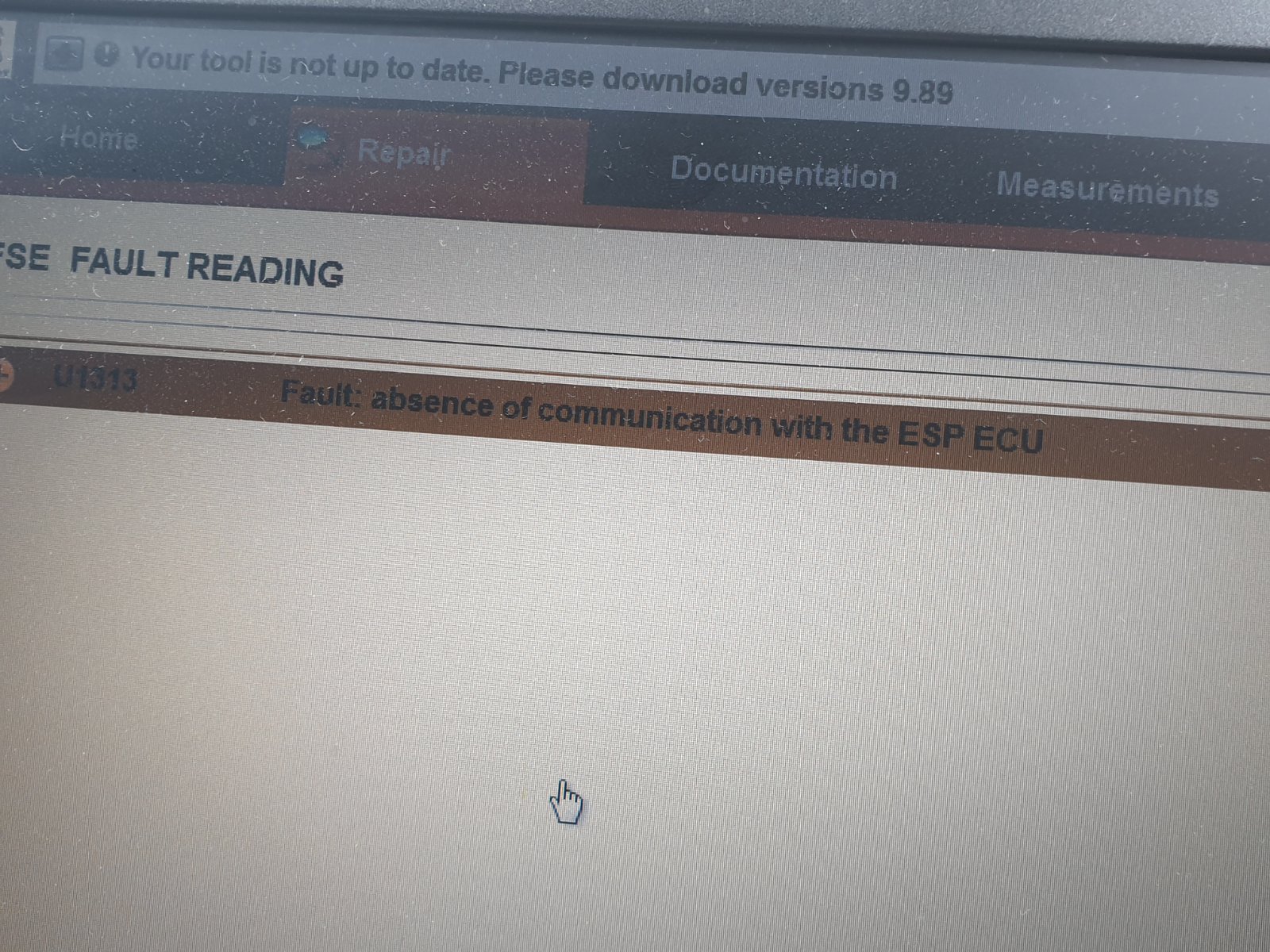

You have a diagnostic software version that is far above the requirements needed for your 2012 car. Version 9.* is really only needed for vehicles from 2016 onwards. Version 7.58 would have been fine for this year.
P0500 is related to the vehicle speed value not being received from the ESP ECU to the engine ECU - which is fine if the car is stationary.
U1313 is again related to the ESP System communication fault and this can affect the following: Engine hesitating, cutting out, Lack of power, Starting problem, Absence of automatic stopping of the internal combustion engine, Deactivation/cut-off of the cruise control or speed limiter, Activation of the cruise control or speed limiter function impossible, Grinding / Squealing / Grating, Malfunctioning of the engine when idling, Malfunction of the Stop and Start switch or its LED, Banging/knocking/creaking, Problem with automatic restarting of the internal combustion engine.
So it really needs further investigation with so many communications faults. I hope there was no damage after you jump started another vehicle previously.

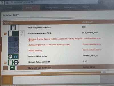

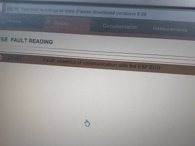

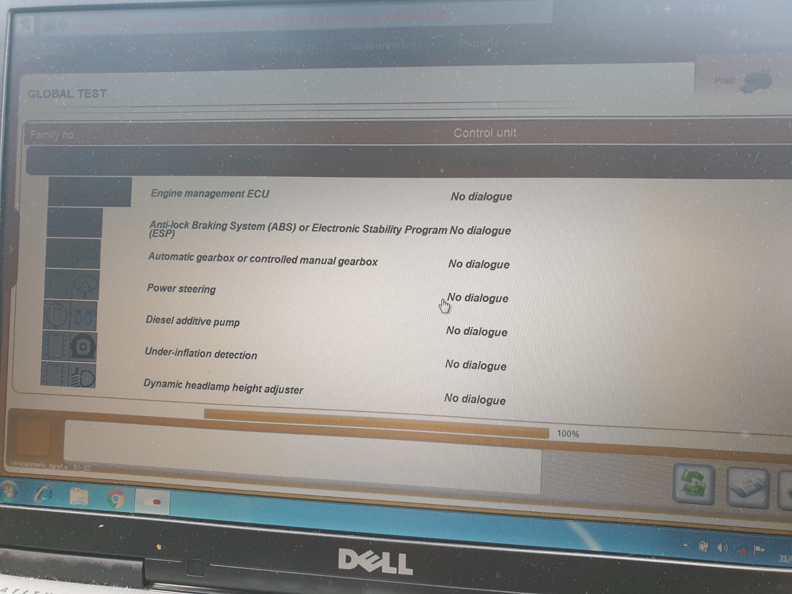

Ok. So latest installment.
My battery charger is ancient so bought a smart charger for AGM Stop Start batteries and left it to do its thing.
Next morning its showing the battery fully charged at 12.6V. It doesn't seem enough to me.
Put it on car, do the reset process. Twice. Doesnt start.
Hook up diagbox.
Get communication errors as per pictures.
Take it all out and check main fuses behind the ecu. All good.

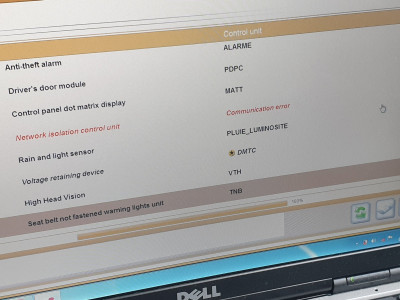

Put back on. Do battery reset. No comms again as per pics. At one point the Network Isolation Control Unit was communicating.
Check battery and it's only giving 12.3v
Am I right to be starting to think this battery is faulty? It's only a year old so I can dig out the receipt for a warranty claim.
Hook up diagbox.

Re: 3008 Diesel. No start. Battery Issue
RichardW. It won't crank due to faults shown.
Says gearbox in m- and engine repair needed.
